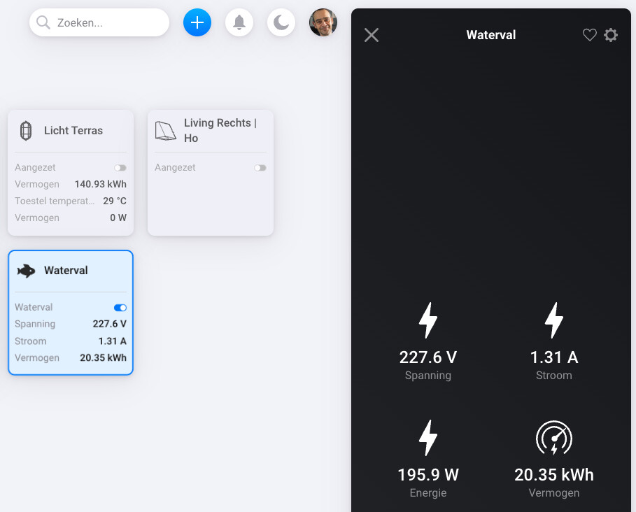

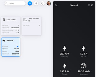

My HAss entities are syncing just fine with Homey. An example:
In Homey, the units can be configured to be included or excluded from Homekit.
For most units, I have it defined as “no” (=default).
So, the original HAss entity is sent back by Homey to HAss over MQTT, making effectively two entities with the same name but with different origins.
But the homey entity over MQTT in HAss isn’t active at all, seems as if there is no payload in the entity.
Is this normal behaviour?

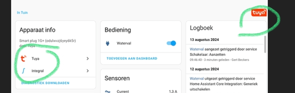

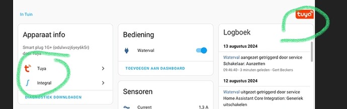

You have the same device at both Homey and HA added with Tuya app / Tuya integration.
It shows by the Tuya logo in HA, of the waterval thing:
So it’s a matter of choosing:
Keep using native Tuya integration at HA, and disable the device(s) in MQTT Hub, or use the “from Homey to HA per MQTT” method.
I don’t use Homey Tuya apps btw, only the HA Tuya integration (because it just works :face_with_peeking_eye::sweat_smile::sweat_smile: )
Thank you for your reply.
I also do not use the Homey Tuya app. A community app without proper support is just an accident waiting to happen.
The Homey entity shown, is not a Tuya integration in Homey, but the Tuya integration in HA, sent to Homey. I understand the confusion; rounding (or trunking) in Homey was non-existent, until recently :blush:
These images where posted to show entities from HA to HO working just fine.
All my integrations are realised within HA because it gives me (total) control which is just lacking in the Homey environment.
I agree about disabling the devices in MQTT hub. It doesn’t make sense to sycronise empty packages. But: why is default state “No” under “Exclude from Homekit” if there is no payload anyway?
About the payloads from Homey to HA, can you please elaborate on the "from Homey to HA per MQTT” method? It seems as if the entities from Homey to HA are always empty (in my setup). How do I do this? I do not have an immediate use case for data from Homey to HA, but I guess I’m just curious. :nerd_face:
Edit : I do have one integration over Homey: Daikin. Unfortunately, my Daikin units are not accessible over HA. This would be an interesting use case…

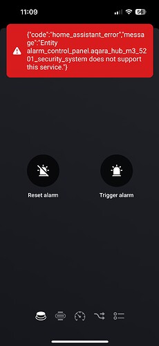

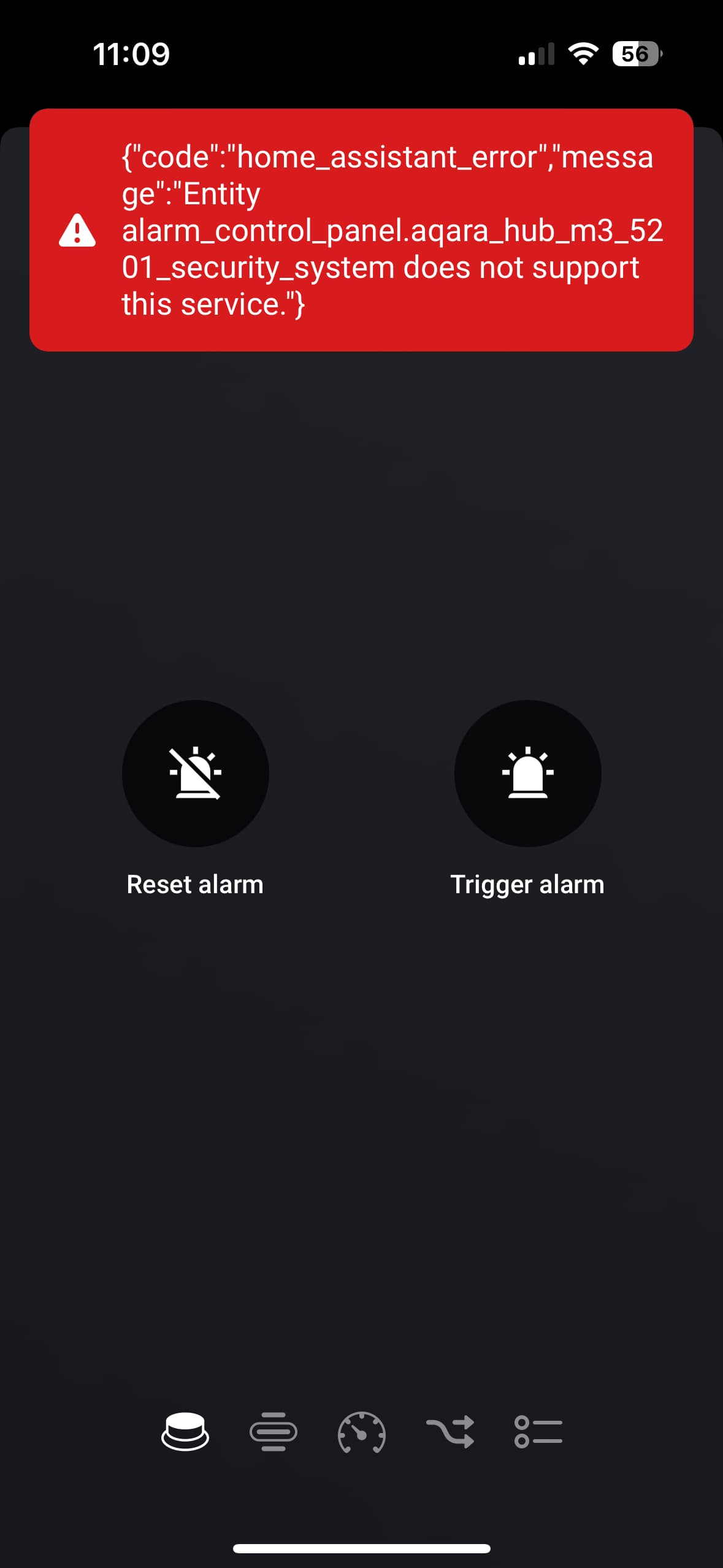

Hi! In Homey alarm device there are options that are missing in HA (armed at vacation, armed custom bypass)
The Homey device has a mode selection with all standard HA options.
You HA device only sopports a subset.
It was not possible to use dynamic Mode lists. I will check if it’s possible to make id dynamic with Homey FW >=12.0.1
But dor now just use the possible modes :wink:
Also can you check Alarm triggers (reset alarm, trigger alarm)?
Can you please post a screenshot of your alarm panel entity from HA developer tools (entity states/attributes)?
