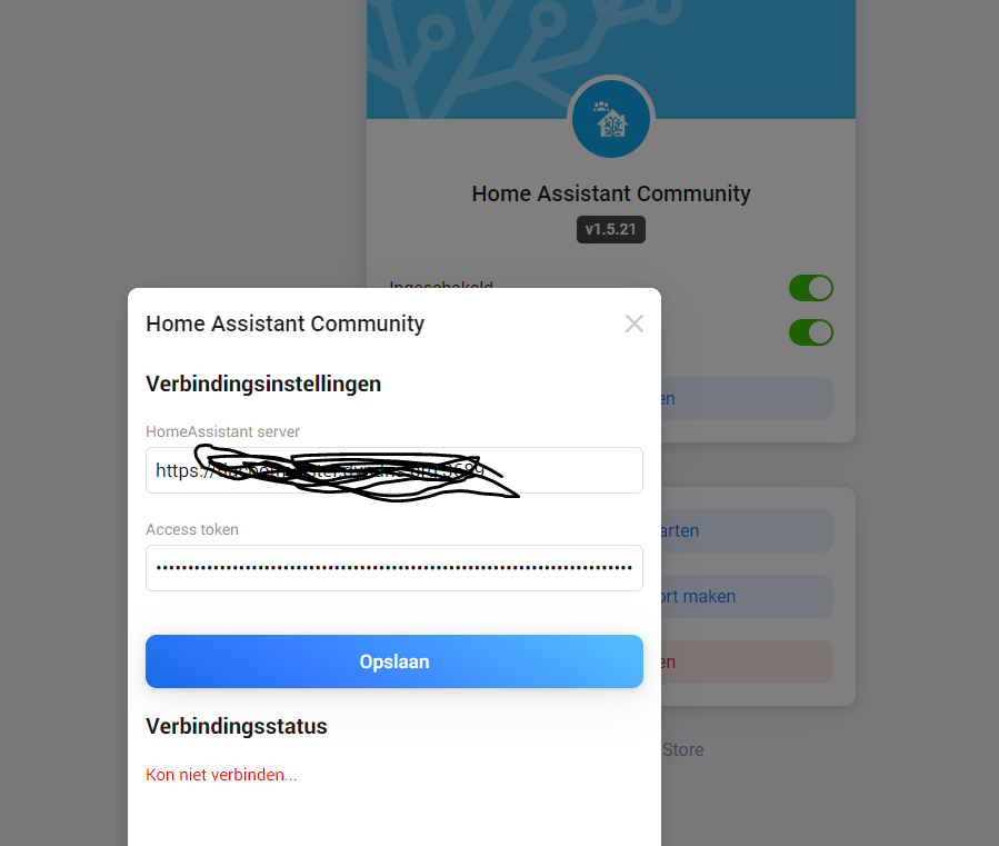

Hi @RonnyW , I experience the same as described here.
Debug log: a01d24bb-e93d-40d7-894a-4c5cadce5940
I tried the latest version of Home assistant community as well as the beta.
Any tips, tricks? I’ve removed, restarted, reinstalled the lot to no avail unfortunately.
I guess it’s on the HA side they’ve changed something (but what…?)
I can only see the error code “1” (ERR_CANNOT_CONNECT).
That means that the app can’t connect to HA via WebSocket connection.
Is it a new app install oder did it work before with an older HA version?
I guess you’d use HTTP instead of HTTPS
I think @Peter_Kawa is right.
You are using dyndns. But locally, your HA is running on http as default. So you also have to use http for dyndns/port forwarding.
Yes, it worked before with an older HA version.
Because of repairs I needed to be done to a propriatary bridge it has been disabled for approx 2 months.
When I re-instated the connection nothing happened so I started troubleshooting.
I tried a local http connection as well.
http://172.x.x.x:8123
Same result unfortunately
I think it can be certificate related when using DDNS.
Error: request to https://xxxxxxxxxx.dyndns.org:3689/ failed, reason: unable to verify the first certificate
HA shows this with network setting;
However, bypassing certificate verification by just plain and simple HTTP results in error as well.
Perhaps you can check again? f86e6dec-3a73-4fc1-a7f0-44263fde8949
If https is set in HA settings, you can only use https, not both parallel because the same port is used.
I’m not sure if selfsigned certificates are accepted. I use https only via reverse proxy and a real letsencrypt cert.
