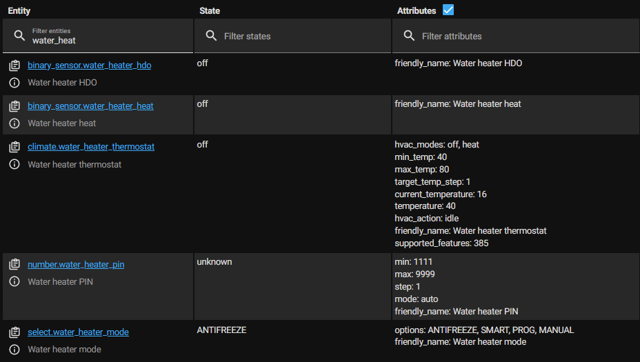

Ah, so you added a climate entity but used a custom icon (water heater) what’s the same as for the water heater device :slight_smile:
Just to summarize…
  • you added the climate entity as climate device. Then you get some default capabilities (temp target/current) and the default hvac mode selection.
  • the Homey device is only showing the default HA modes. I your case, the flow card should show the custom modes from your climate device (off, heat).
When using the mode flow card, the service climate.set_hvac_mode is called with parameter hvac_mode: mode. This should also work in HA developer tools if you start this service there.
But in your case, it seems this are only some dummy modes and the real modes are defined in the select entity.
You can add this select.water_heater_mode in repair view to your climate device. Then you should get a new flow action to change the value for this entity. That should change the mode of your heater.
That’s the bad side of HA devices…it just a collection of entities :wink:

You might be actually a step ahead - I did not intend by changing Homey HAC thermostat device (Water heater) states to directly change device / entity in the HA (because of the non standard / dummy modes) - I’m setting the states already different way using CALL SERVICE. But naturally it was never reflected in that particular Homey HAC Thermostat device as such, so I was thinking to check the states and update/reflect Homey HAC thermostat device state accordingly. But my problem is that by calling SELECT THERMOSTAT MODE , the Homey GUI / device do not change it’s state at all - I thought I can kind of force it using this action (and vice versa - if I will change it using the device, then using CALL SERVICE, reflect it back in the HA. I was trying to avoid Device capability virtual device but seems I have no other choice, correct? :slightly_smiling_face:
The thermostat device (and the mode) will only change when the mode changes in HA - or when you select a mode manually what will have no effect for you in HA.
However, if an entity uses non standard modes in a climate entity, you will never see the correct state in the device GUI, because this mode list is predefined in the capability definition.
But adding the select entity to your thermostat device, you will see the current mode as sensor.
You still can’t contol it via device GUI becaus it’s not possible to set a list seletion programmatically.
But you get the value synced back to Homey when the state changes in HA.
And you get a autocomplete list in the flow card. I thinks that’s easier that using basic service calls.
I don’t see another better way.
