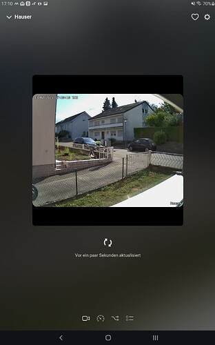

Thanks guys. So it’s like for most devices that the additional data is implemented as standalone sensors and switches. So I would say the camera is what it is - just a snapshot viewer :slight_smile:
Do I see the neighbor’s infamous scooter on the left? :sweat_smile::crazy_face:
Very attentive and correct !
After the unpleasant incident with the elephant toothpaste, he has become a little more careful.

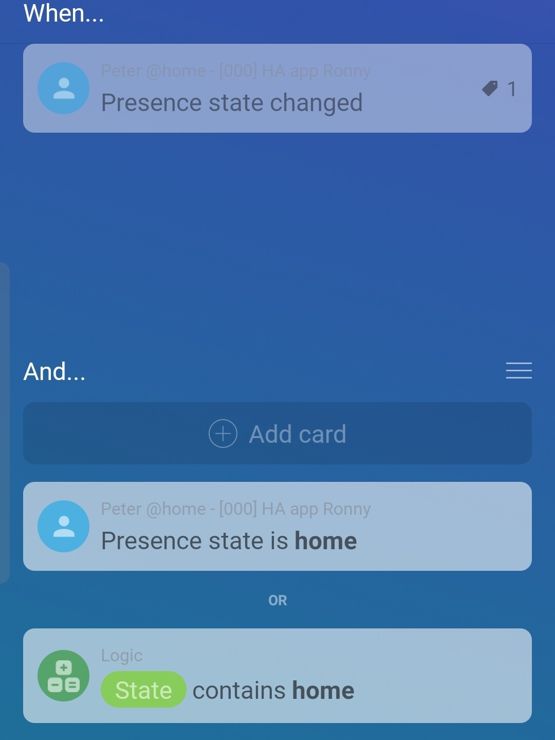

It should be equal to the Presence device @ Homey:
This flow should work in theory:
If it’s a presence entity in HA, you should be able to add it as presence device.
Then you can use the trigger, Peter suggested.

Ronny i have done that. Added it as a presence in homey
I think i got it to work when i am using logic card insted :+1:
Thanks for all the help. You are the best
Yeah I noticed “And” cards from other apps don’t always work (as expected), but the logics cards always do.

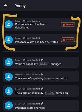

But you can use the triggers for presence on/off and the condition card for active presence alarm instead. That’s based on the alarm capability of your Homey device and not based on entity states.
There are 2 capabilities in the device.
1st: the alarm capabilitiy (where the trigger/condition above belongs to)
2nd: the state (the entity state from HA). Thats a text value.
But it can be that a capability is changed in the app, the trigger is fired and your flow is started while the second capability is not updated yet.
So using “presence state changed” and “presence state is” should be ok.
But I still suggest to use the alarm trigger and alarm cindition because it doesn’t need to set a text value and is easier to use in flows.
