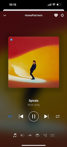

  • Added media image support fot http URLs
@basvanderploeg Ready to test :slight_smile:
Awesome! Works like a charm. Thank you!

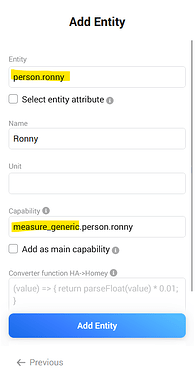

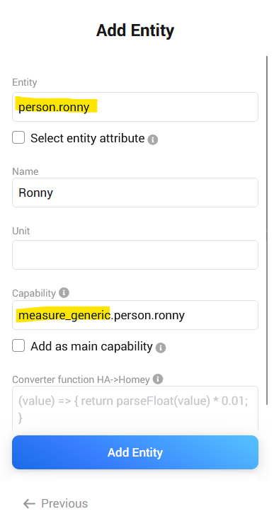

Does anyone know what capability I can use for text?
I’d like it to be on the same page as the sensor data, if possible…
measure_generic (in the HA app).
You can add a text entity as sensor device and it will get the text sensor. Or you can add the entity in repair view to every device. When selecting the text entity, the capability is preset as measure_generic.entityId (subcapability).
Thanks, but I cannot add this measure_generic in the yaml on the HA side ?
I’d like to make several compound devices and keep everything as clean as possible
-=edit=-
Nevermind that seems to be working, thanks again!
Yes, you can. When using more than one mesaure_generic in one device, you have to use subcapabilities like measure_generic.01.
