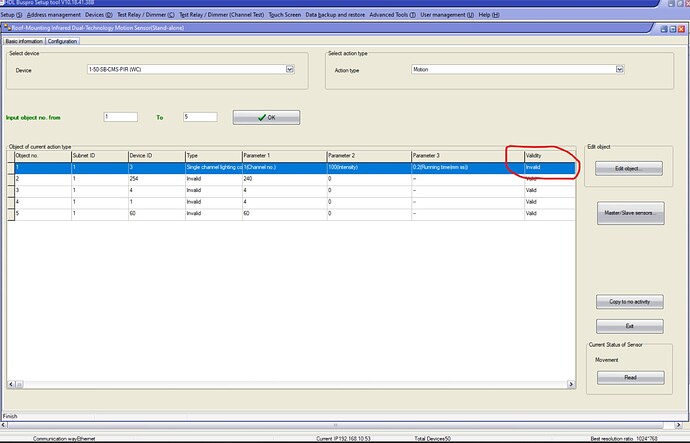

Hi @Fredrik_Meyer-Lampe.
I’m using UV for control between HDL and Homey, in both directions. Without problems. And it works realy fast.
On HDL panels I use the command ā€œUniversal switchā€, see example below for UV16. I’m using Logic controller to act on UV commands from Homey. (For HDL setup I use ā€œHDL Buspro Setup Tool2ā€ on Windows 11)
