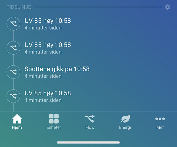

I am able to get the Logic controller to react on UV sent from homey. However I am trying to get away from using the logic controller and using HDL panels to start flow in Homey instead to enable (night mode etc).

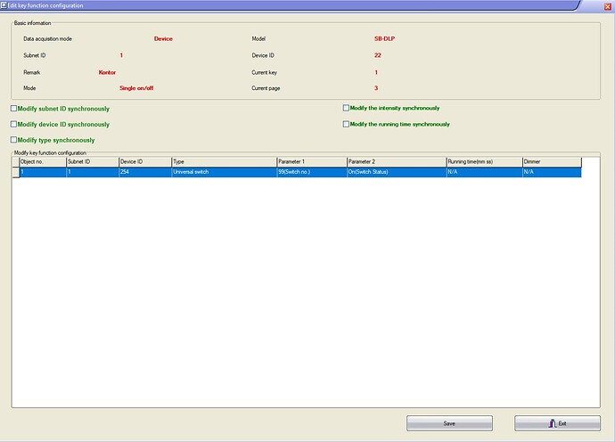

Setting up a button on HDL panel to send a UV.
Making a flow in Homey
https://homey.app/f/aTlcki
This works, however the problem is that the flow starts, and UV is set without anyone pushing the button… this happens for many different UV swiches which I am really confident is not i use…
Since I have disabled the logic controller I tried with one the UV’s that has been my main logic for night state. The logic controller did not respond on this when it was active, so for me it seems like my Homey responds to more UV’s than the Logic controller, telling me that i might something with how Homey is sniffering for UV’s `

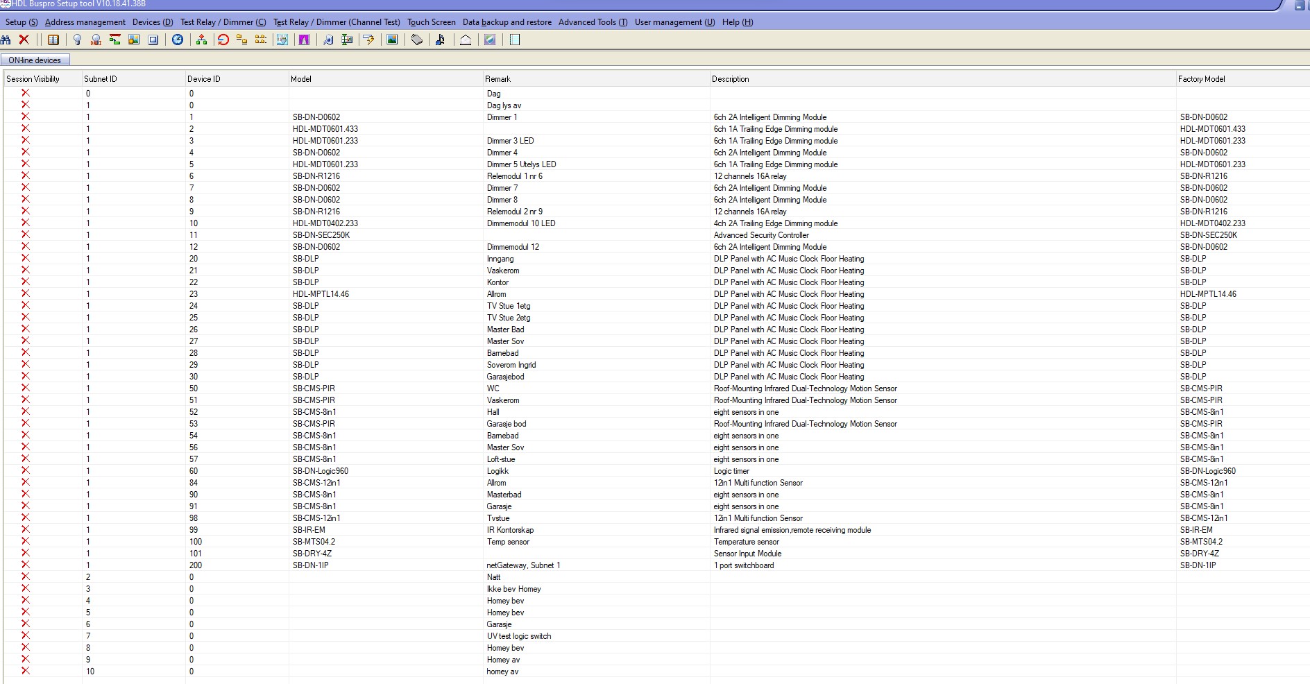

I do have HDL Bus equipment from 2011 and is starting to consider whether or not that can impact?
See device type list.
I did also log the UV on my timeline, and will try to look for commands in HDL command test (to see what initiates the UV switch…

Now I just have to find a solution to the UV challenge, since I am not able to use the HDL panels to start anything on Homey. If that is sorted out I am really getting there.

Hi @Nichel. I suspect that the PIR you are mentioning sends signals like the multisensors, and as such can be added to the app as the same type. The problem is that I can’t find any type id for the unit you are mentioning (hdl-smartbus-homey/defDeviceType.xlsx at master · alydersen/hdl-smartbus-homey · GitHub), even though there are other MSP02.4C-versions there. Can you somehow get the type ID?
Its the sensor with devicetype 323 in your list. Its a PIR and LUX sensor for ceiling mounting.

Have you found a solution to your problem? I’m also using HL DLPs to initiate flows on Homey, like starting Sonos or the robotic mower by using flows. I also use UV’s on Homey to remotely “push buttons” on DLP panels. It goes without any problem, and nothing “works on it’s own”.
The command I use on the DLP is, as I described in my example above, is “Universal swich”. I use direct adressing to the UV on Homey as HDL device, not as broadscast.

I am able to start flows from the DLP with UV,s. The problem is that the flow also starts without anyone pushing the DLP button and that the UV switch is recognised without me knowing why
