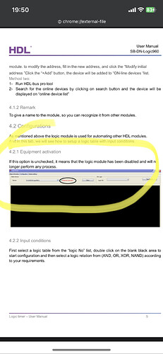

Are you all still using the logic module in combination with Homey? I was considering disabling the logic module if that is possible to see if that helps
I will also try to start on a best practice guide when time allows
@Fredrik_Meyer-Lampe I’m not using the logic module. I have some direct communication going from motion sensors to relays, but almost none left. All other logic is left to Homey.
Good to hear. Do anyone of you know if it possible to just disable the Logic module, so it can be enabled again, instead of removing all content
Updated: seems like a found a way to do it
