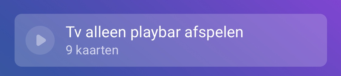

What am I doing wrong?

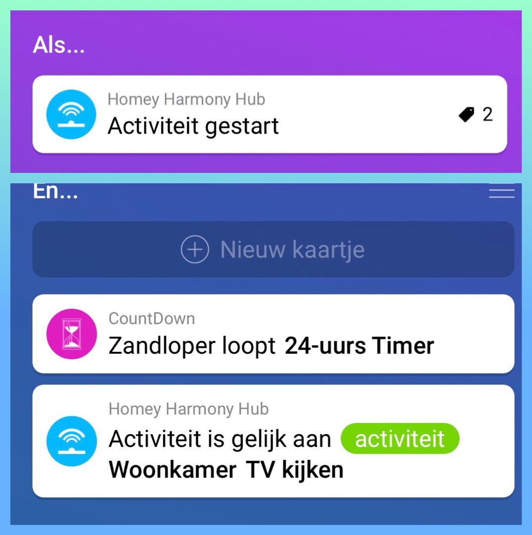

I use Activiteit gestart (activity started) and that works. Maybe you can try that and see if it works
When I type the name of the activity in the place of the tag the flow isn’t greyed out anymore. I suppose this does the trick. I will check later on.
Does not work at this time, have to look what i am doing wrong
In the card in the ‘And’ section click on the tag and select ‘Activiteit’ under local tags. Then select the hub and the activity.
Also I do not know if it should matter but in the When section I have ‘Activiteit gestart’ and not ‘Activiteit wordt gestart’?
If I do so, the flow gets greyed out

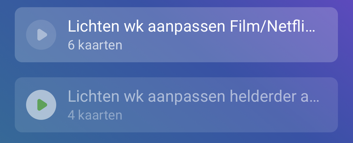

@Marcel_Ubels Only the ‘play/start’ button is greyed out, the flow is active (the text on the flow is white, if it is inactive this is also grey). The play-button of a flow is only active when you are able to start it manually, but because in this case it is depending on a certain tag to be valid this is not possible. This is basic Homey stuff, I assume it is explained better somewhere else also.
So your flow should work now.
See for instance these two flows, the top one is active but cannot be started manually, the second one is not active but can -should it be active- started manually.
Ok very clear. I will test if it work.
