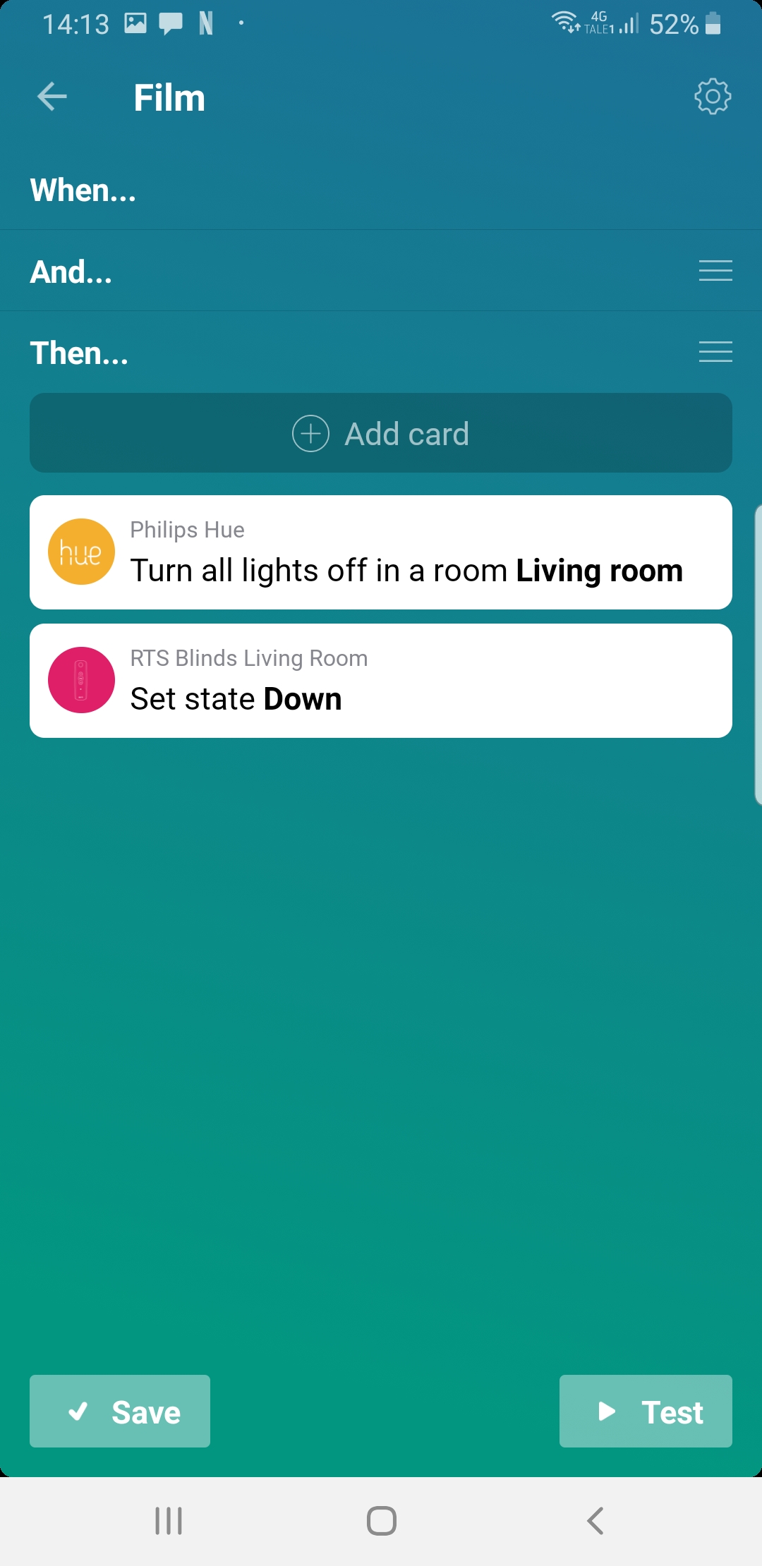

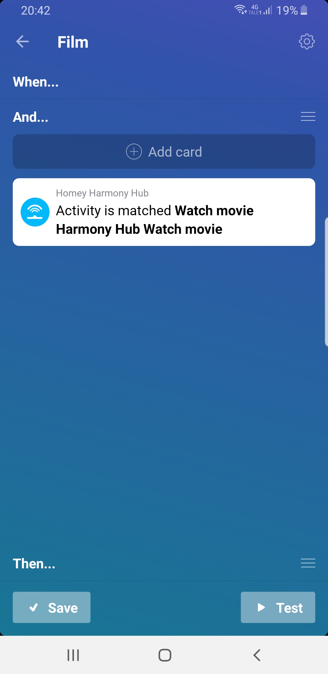

Hi! This might be a general flow question as I am new with the Homey. Hoping for some help :smile:
As I understand the Homey Harmony Hub app can register that I push an activity on the Harmony Remote through the Harmony hub. I tried setting “When Activity starting” card and "Activity is matched to Watch movie"then “Turn off lights and make roller blinds go down”.
When I try to test it comes up with the activity tag and wants me to write the name of the activity. I thought that the Homey got the activity name through the Harmony hub and Homey Harmony hub app. I have probably misunderstood something here :slight_smile:
Thanks for any help!
Did you install the activities?
Thanks for the replies. Yes, I have installed activities. I changed the “tag” to text matching the activity. Now the blinds go down and the lights go off, but this happens every time I start an activity, not only the “Watch Movie”-activity. All other cards are the same as prompted above.
Thanks for the help
Works like a charm! Thank you! :smile:
