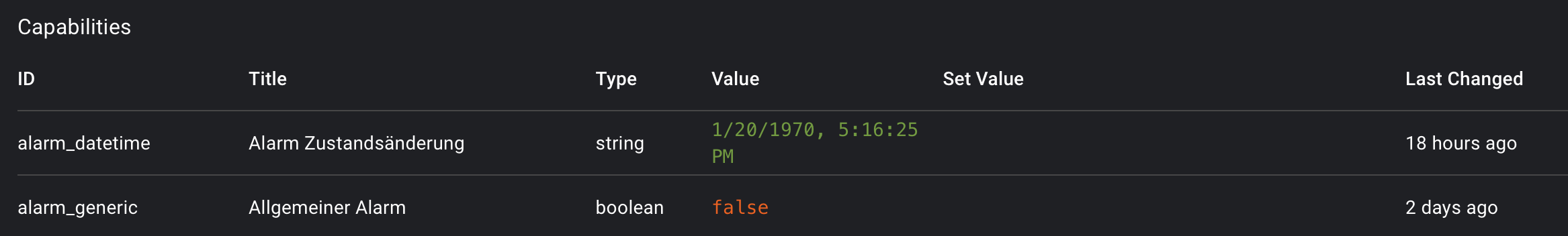

I’ve different window/door sensor in use with group app. If I add a new group and choose “sensor” → “contact sensor”, I’ll get this devices:
  • Aqara window/door sensor (zigbee / class=sensor)
  • Eve Window/Door sensor (matter / class=sensor)
But this devices are not shown:
  • Telekom DECT window/door sensor (fritzbox-bridge / class=other)
For the last one I can change the type of class in device settings and switched it to “sensor”:
I used the developer tools to verify this:
But if I want to add a new group and choose “sensor” → “contact sensor” again, the fritzbox-bridge devices are not available. I already restarted the group-app, but it doesn’t matter.
How can I solve this ?
Please check in Developer Tools → Devices which capabilities the Telekom DECT Sensor uses. This is the important parameter to recognize the sensor as a door/window contact sensor.
It must be boolean capability type named alarm_contact.
Thank you @DirkG ! I checked the Evehome window sensor and it shows this:
But the Telekom window sensor does not:
It uses alarm_generic also when switched to type=sensor.
Now I used a blended group. The sensors are shown and can be added. The alarm_generic is used by default, after creating the group.
Thank you for this hint :slight_smile:
