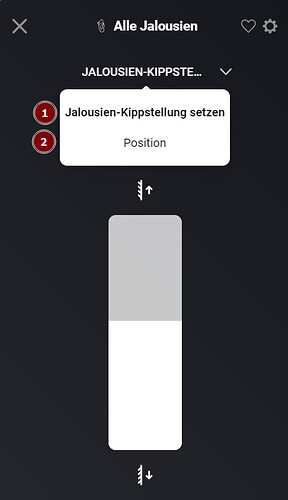

HI, i have the same problem with fibaro 3. Up and down are working and i can also see the tilt option in the group itself but cannot use it in a flow. Version is v3.2.4

The group app never specifies any information for flows - it just uses the default (athom) capabilities with their (athom’s) default flows.

Its actually been a long time since I looked at the code, so I just double checked.
This is the code for a device (in this case blinds)
Pairing Driver :
class BlindsDriver extends Group.Driver {
    onInit() {
        this.class = 'blinds';
        super.onInit();
    onPair( socket ) {
        super.onPair(socket);
Device :
module.exports = class BlindsDevice extends Group.Device {};
There is literally only 1 line of code different between each device type, and that is only setting the device.class on pairing. (which gives you different defaults on your titles etc).
There is no code at all for any flows, its all handled by Athom. I am more than happy for the person who told you its an issue in the app to contact me to explain how that could be possible. But im not holding my breath.
