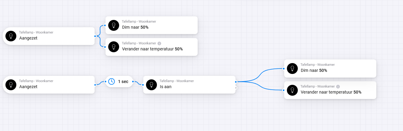

I have a device containing 2 lights, added as a light but the same issue occurs when I add it as untitled device.
Flow: when light turns on, send message
When i press the light tile, it sends a message for turning on but also for turning the light off
Seems like ‘light has turned on’ acts like ‘light status has changed’
Same happens when i make the flow:
When light turns on, and light is on, than send a message.
That flow also sends the message for both putting it on and off.
When i edit the flow a little further, the problem is gone:
When the light has turned on, wait one second, and the light is turned on, then send a message.
That one works as intended. It does not send a message when the light has turned off.
So the first one is what i want but it doesnt work and the 2nd is the workaround:
It looks like the card triggers before the actual status has been updated. Hopefully there ll be a fix :ok_hand::+1:
