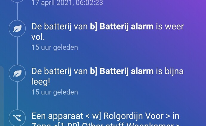

***) ( @Jamie ) I have all battery sensors grouped, when the app restarts, or Homey, it reports an almost empty battery, quickly followed by a 'battery is full again" notification:

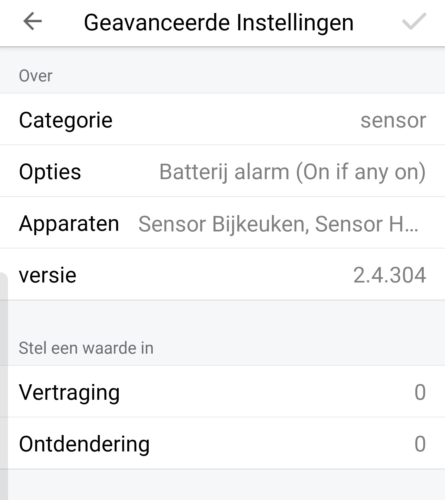

Device settings:

ISSUE: As stated above here, when sensors are grouped, and Homey or < group > app has been restarted, it triggers a sensors alert, followed by an 'all sensors OK" alert
