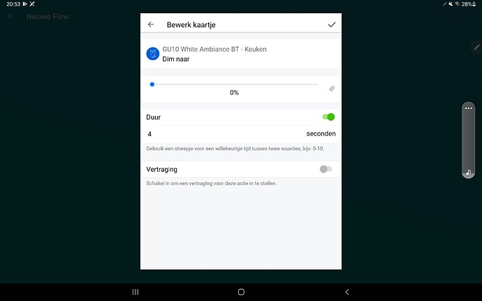

Hi, i have 6 Philips hue GU10 White Ambiance BT lights in a groupe.
When the lights are in a group in the flow card under dim to the duration is not available.
When I select a single light without te group app this option is available.
Hope there is a fix, now the light jump instantly two another dim level.
Thanks

What I actually mean is for creating a smooth transition between dim levels.
This is also discussed around post 130. When my lights are for example at 80% en I dim them to 20% (movie time) they jump to 20% instantly, because I cannot set the duration in the groupe flow card, and its set standard to 0 sec with the hue lights. In the dim level flow card of the lamp by themselves this is possible, for example 4 sec the lights go from 80% to 20% smooth in 4 sec.
Hope there is a fix, otherwise the dim function in a groupe is practical unusable.
