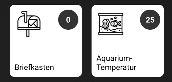

Can you please add more icons? I would like to use a group of lamps as icon. Thanks!
Or make it possible to use own icons, like it can be done with „Virtual Devices“ App. That would be great!
This ^^

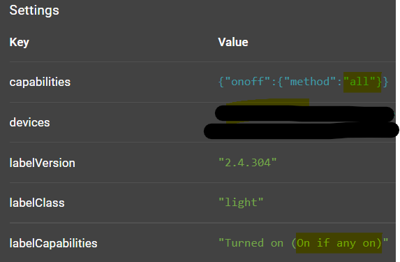

@Jamie: seems that the capabilities method and the lable description are reversed?

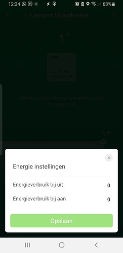

Is there any way to exclude power usage of groups from the Homey Energy overview.
I’m now having a lot of power counted double or even three times.
E.g. Heater is counted individually, as part of the heater group and as part of the overall power group.
How about:
At the energy tab you can also set the energy level

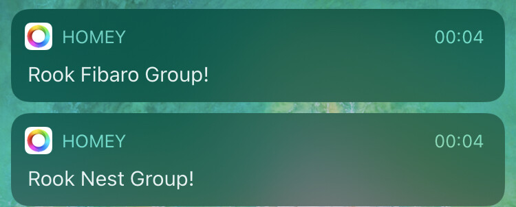

I have created a group for all my smoke sensors (Nest and Fibaro). Since that moment I am getting an alarm at a steady time 00:04 at night. None of the sensors gave an alarm (in Homey) nor audible either. So I decided to split up the Nest and the Fibaro sensors in two groups. However it does not change anything, still I am getting an alarm on both groups (see attached image). I have used the setting “on if any devices are on”, which makes sense. Is this perhaps a bug?
