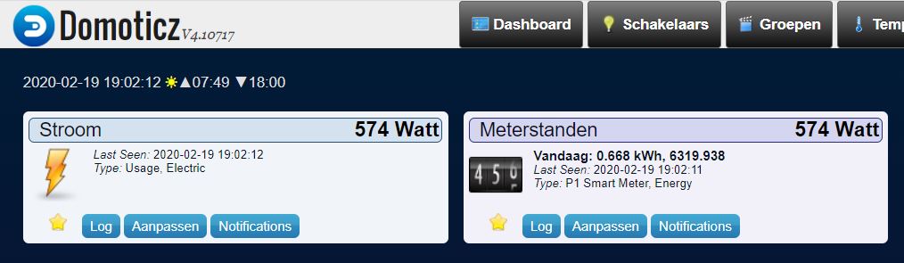

I just got my Homey today and installed your domoticz app.
On my synology i have domoticz running, a P1 smart meter cable is connected. In Domoticz i can see the current usage and the “Meterstanden”
Homey connects to my domoticz and sees the device, i can add Current usage and “Meterstanden”.
Unfortunatly it displays no values :frowning:
What am i doing wrong ?

@Jeroen_Somhorst
I removed and installed the app a few times and added and removed the P1 Meter device (2 devices / Stroom & Meterstanden)
I tried installling only 1 of these (Meterstanden) and then the info was shown in Homey, when i added the other (Stroom) the information from the devices were gone. (Both meters were shown in Homey, but without info)
I had to uninstall the devices and the app again and start over.
Once again installing the app and only adding the Meterstanden, the info was shown.

It works for me, but only if i only add the Meterstanden device (then one with all the info)
