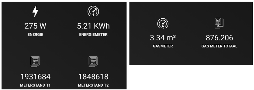

Thanks @Jeroen_Somhorst , works great, the only thing what I’m missing is the decimal point in the T1 and T2 display’s, in the Gas display, the decimal point is shown as it should be.

01
value = (DomoticzDevice.getMeterValue(data.Data,“T1”))/1000;
value = (DomoticzDevice.getMeterValue(data.Data,“T2”))/1000;
This solves it for me but maybe there is a better solution?.
@Jeroen_Somhorst can this be included in the next version?
