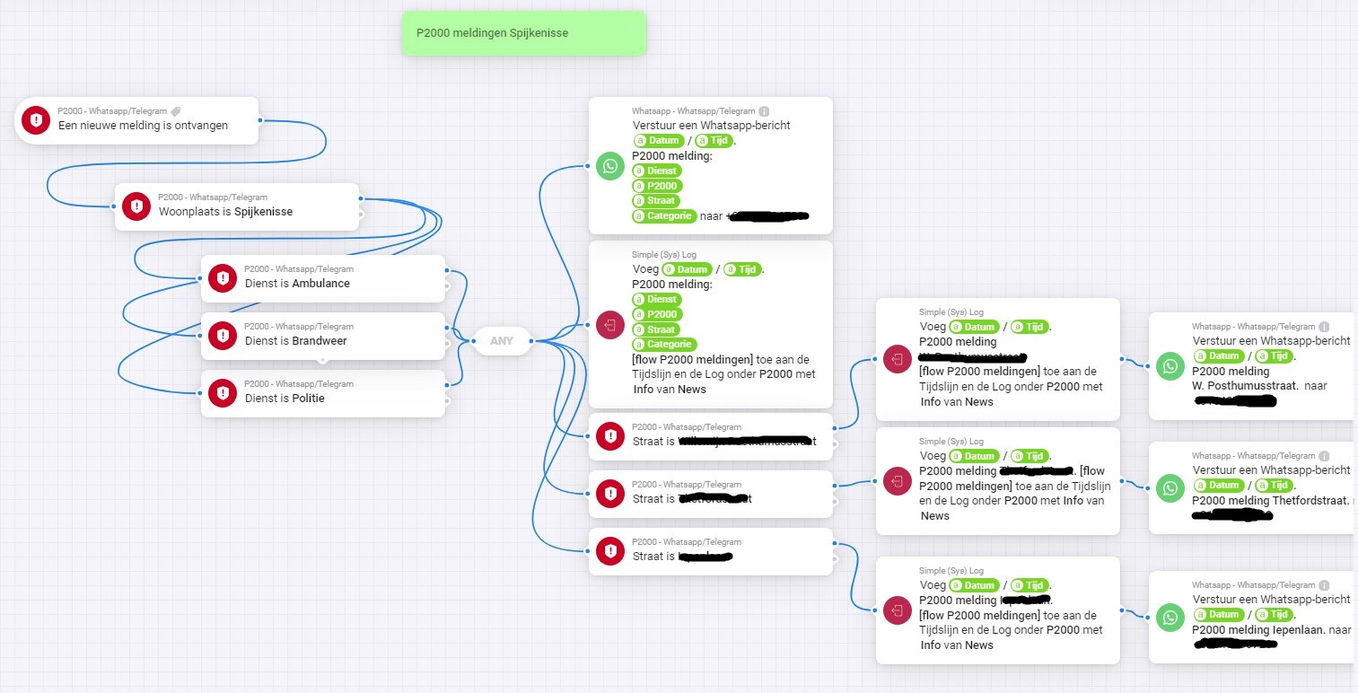

Oww haha. Please can you share your flow?

Why the capabilities don’t update I need to dive into. The app otherwise works. Just get them in. No problems with WhatsApp? You’re sure this one works?

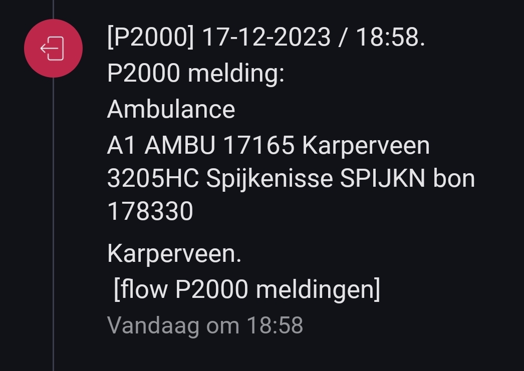

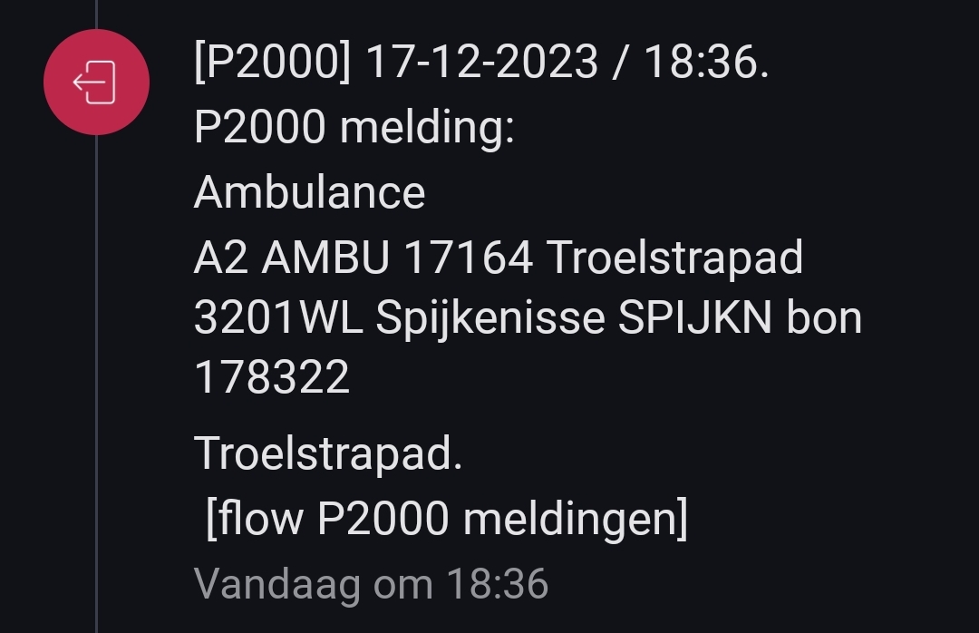

There are no issues with WhatsApp.
It works fine for a short period after a restart of the app and in that time notifications are coming in on my timeline and WhatsApp.
Until it doesn’t. There is not much I do or can do about it.
These are two examples that it works when it works.

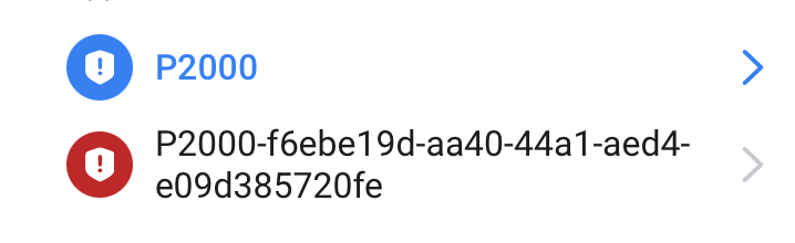

I think I see the “problem” after update I see two P2000??
And you performed this operation after the last update? [APP][Pro] P2000 for Homey (Dutch 112 (911) alerts - #368 by LRvdLinden
It’s not because of the update but you created a 2nd device while watching flow to your erdere device. You need to convert the flow and make sure you have a new device after the last update.
Here the app works perfectly with multiple devices at the same time.
