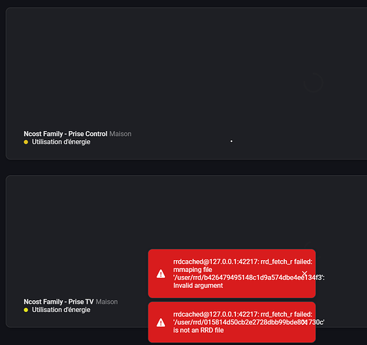

At my level I have a little problem, I can’t see the consumption history in homey (insights), this gives an error message (rrdcached@127.0.0.1:42217: rrd_fetch_r failed: mmaping file ‘/ user/rrd/b426479495148c1d9a574dbe4ee134f3’: Invalid argument),
think you know where the problem could come from.
I thank you in advance for any help you can give me.

@Ncost974 - sorry for my late response, I had to think it through a bit.
I have a few questions:
  1. Can you please explain exactly how do you try to see the consumption history? A screenshot of what you are trying todo would be the best
    I tried taking a “power outlet” of my app and add “Power Usage” insight like this:
Is this what you are trying to do?
  1. Is it related to a specific device? If yes, which device is it that you are trying to monitor? Can you try with a different device? Is it the same result?

So it’s to see the consumption history of my sockets, and both have exactly the same problem, but I have the instantaneous consumption on the home page. Thanks for your help.

@Ncost974 - can you try doing this with a different device type from my app (for example, a light switch or any other device type that you have)? Do you succeed in doing this for devices in other apps?
I, i sent you an invitation to my home.
