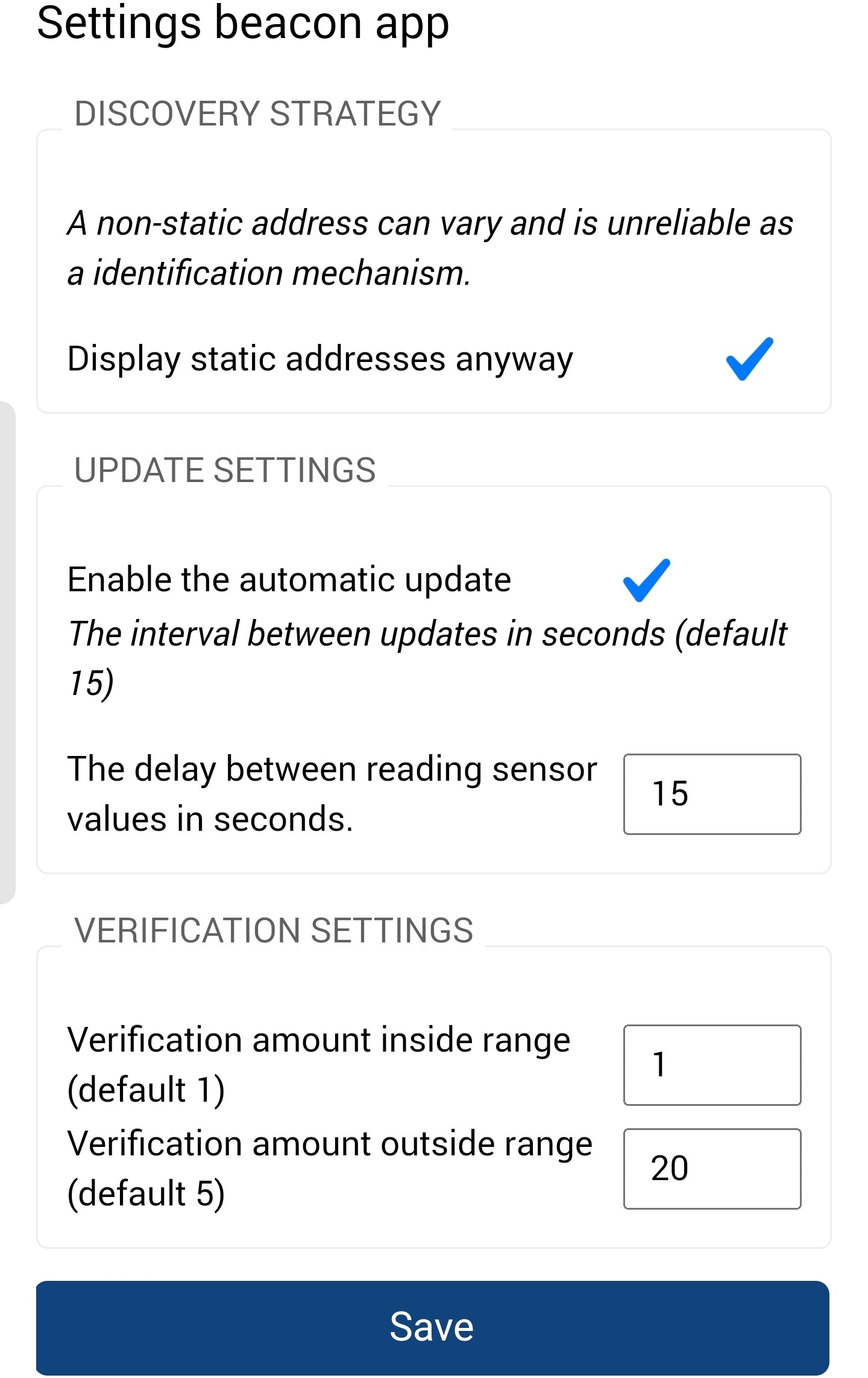

For my Tile Pro 2018 i use the setting 15, 1 ,15.
You can play with the last “out of range” setting and see what is good in youre situation
With 15 the time to be seen as away is longer but i have no unwanted disconnects anymore
And maybe the newest firmware will give some better results…

After installing the latest Homey firmware and put the settings back to 15-1-5 i had no false discomnects anymore

I was on 16-1-10 and just altered it to 15-1-5.

Hi there. I am using a Gigaset G-Tag connected with the beacon app. When I create a flow using “when the beacon is inside range” and connect for example a hue light with that trigger after some minutes the flow will be deactivated with the timeline message “Flow XY has been deactivated because it has been executed too often” (I don’t know the original message - I translated from German). This message appears more than 10 times in my timeline then. So I assume that the G-Tag sends too often its status or something else happens. I tried the same with the trigger “when the beacon changes”… Same effect! By the way: What does “is in range” mean? When it comes into range? As long it is in range? The first time it comes in range? Obviously the beacon often sends the signal that it is in range and triggers the flow very quickly and several times… Even when I do not move the G-Tag to another place.
Anyway, I cannot use the beacon to turn on my lights when coming home or open my Danalock. Is there a mistake I am doing or has anyone an idea for a solution? THANK YOU SO MUCH!!! I am very desprate. Best regards, Michael
(I am using an iPhone 12 Pro and HomeyPro - everything at the newest software release).
What are your config settings?
In my case, the beacons get reported out of range after 15sec x 20, so it’s impossible to get ‘Flow XY is deactivated’?
I tried the settings you suggested. This time I did. not receive the message that the flow has been deactivated and it stayed activated… but: my Danalock didn‘t stop to unlock… After the fifth time unlocking I deactivated the flow manually. Same effect when I set as action a push notification: I receive a notification several times. Very strange effect. Any idea?
How does the device log look @ your Homey?
