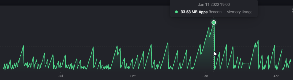

Just analyzing impact of having 7.4.0RC22 but Beacon app seems to be taking more mem with longer uptime anyway…
Last 31 days mem usage
I think that’s not problematic at all. If the memory useage exceeds 40MB’s it starts to get worrying imho. Apps get killed if it exceeds ~80MB’s
It depends as those drop-downs are regular reboots. Here compared with another app from Koktail - as you can see it behaves differently. And btw, I have just “two beacons”.
Unfortunately the latest RC seems to be more memory hungry, so me having 59 apps running, every MB counts :wink:
Ah, that changes it. But you don’t know (yet) how big it grows if you don’t restart Homey?
My Beacon app uses 6~7MB’s average (I’m on v7.3.0 by the way)
Same “problem” here, I’m around 32 apps on a “half” Pro.
Oww that would be a bummer.
Hi Sharkys. I have seen this behaviour before and have not found anything that will resolve it. The Homey app’s memory is automatically cleaned with the garbage collector.
The apps core functionality is polling the BLE stack from Homey. I can imagine that adds up to the memory consumption.
Anyone that want to test a longer update interval to check if the memory consumption is lower?
Unfortunately I’m restarting regularly but since 04/2021 I see the highest peak was 34MB - so still below 40MB - but it’s nice contrast with Flora app, where I have 6 Flora sensors and it’s still running on ~9MB, compared to Beacon app, where I have just two “dummy” sensors - kettle and boiler detection. While Flora app mem utilization remains almost stable, Beacon is going from very nice initial value of 7.4MB to ~34MB.
obrazek
Maybe @Koktail you might see something strange in the logs ? Just in case : 61768edb-cef9-42a9-a60a-62aa80a636aa
But as already pointed out by @Peter_Kawa , it’s probably not issue at all - I was just wondering why this app is more memory hungry compared to others app, including those using Bluetooth stack.
Hi Sharkys. Could not find anything strange in the logging.
The big difference between the beacon app and other BLE apps is that this app is using the discovery mechanism to detect BLE devices. So from a technical perspective the issue is pointing in that direction.
Because I didn’t find any other cause, and the BLE discovery is Homey core firmware I cannot do anything about it. And the stacked memory that is allocated is freed by the garbage collector anyway after some time. And the memory doesn’t exceed the prescribed maximum values.

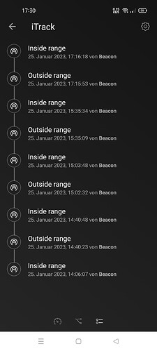

But know I’ve got an issue very similar to other user, especially to Peter_Kawa. This is the reason, why I wanted to reply to his post for asking for a solution, because I’ a little bit unsure about the right seetings (I didn’t changed the default ones).
As you can see on the screenshot, regularly after 20-25 seconds, the outside range status is changed in inside status. In the meantime, the beacon was moved only in direct range of Homey (not outside of our house).
Is this a matter of a too less number of verifications out of range? (even if it seems to be a trivial question… :innocent: :grimacing:)
I would be very grateful for any reply!

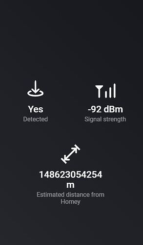

Sorry…just one more question from me as a newbe:
What’s the difference between an Beacon and a iBeacon? I didn’t find any explanations on this question by searching the topic.
I’m asking this question myself, because I want to rule out of course, that I added the wrong type of beacon to Homey.
I just red something about random addresses as an advertising signal from some beacons. And I was wondering, if mine is such one (see screenshot as follows). Even because of its default name iTrack
