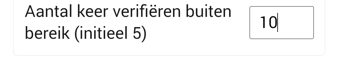

BLE stability improvements in this firmware update, but clueless how to read what they updated :smiling_face:
I will play with the settings to see if there are improvements
Still unstable at the 10 times settings. Back to 15
Hey Peter,
finally, I found time to answer: thank you so much for your both quick and especially very kind response! :ok_hand: :clap:
It’s really helpful while logical, although I didn’t tried out yet. But this is what I’ll do next, maybe in combination with a higher verification amount outside range. I figured out in the meantime, that 15 times seems to be the best - just at the moment. :man_shrugging:
