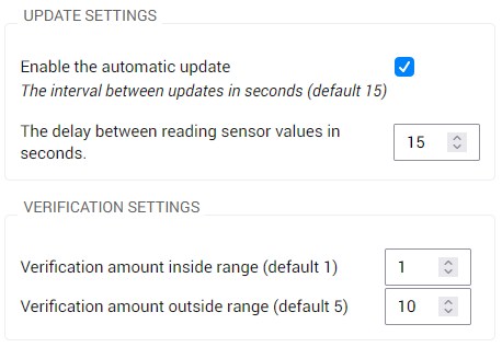

After quite a while of absence, I got back finally to the presence detection of Homey and its alternative using BLE beacons respectively.
As I already mentioned above in January, I owned a musegear finder 2 (musegear finder 2 (dunkelblau) – musegear - Innovative Accessoires) for this intention. I still can recommend it, especially regarding its battery consumption (after 9 months, it’s about 90% according to the official app, which I didn’t use anymore to let the beacon found by Homey).
3 weeks ago, I reinstalled the beacon-app on my HP 2019 with the latest firmware (10.0.3).
The inclusion of my BLE-Beacon (as an iTrack) worked like a charm without any problems. You can see the apps settings as followed:
grafik
Although I got the message, that this topic has been solved (for whatever reason, it seems to be still unsolved :flushed:) as I wanted to reply, I just like to inform you about my experiences:
In the approx. first 24 hours, the inside/outside detection worked well. But suddenly, after this period of time, my beacon was never detected. Neither after restarting the app, nor Homey Pro itself. :face_with_raised_eyebrow: :man_shrugging:
So, also that I’m sad about it, I have to agree with @Osten_Westermark conclusion, that it’s not a HP 23 related issue. From my sight, it seems to be a general soft- or hardware problem of Homey.
