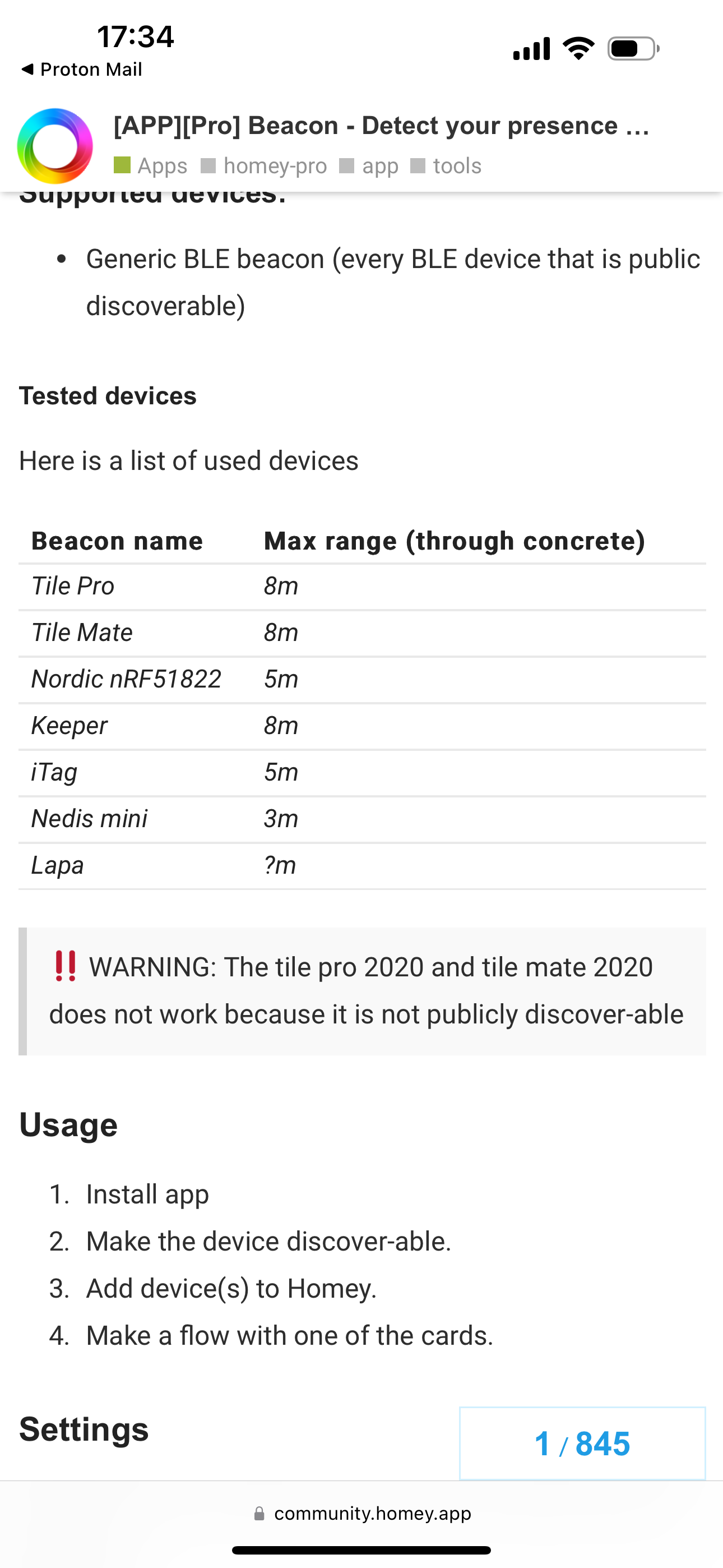

Just got two Tile Pro beacons and wanted to ask how can they be detected and in which category BLE or iBeacon? I tried several ways and they don’t seem to get detected in the app
Tile 2020 and up can’t be used (they cannot / will not communicate with 3rd party apps).
Tile 2019 and older should work though.
I use Feasycom beacons, but € 2,- Ali beacons also work fine.
Maybe the list can be updated as it is unclear. I thought that only older models were not working :confused:
