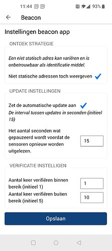

My tile pro 2018 is sometimes a few seconds ‘gone’ then it pops up and marks me as home again… this happens sometimes during night. The Tile is always in my jacket in the hallway 4 meters away from Homey
Do you use the settings: 15-1-10?
Sorry can you point me in the right direction? Lost the context here…
Go to the app settings and use this settings:
That is stable for the most of us
Thanks! Changed it. Hopefully this solves that issue :slight_smile:
Did it solves your issue?
I think so! No connection loss thusfar
