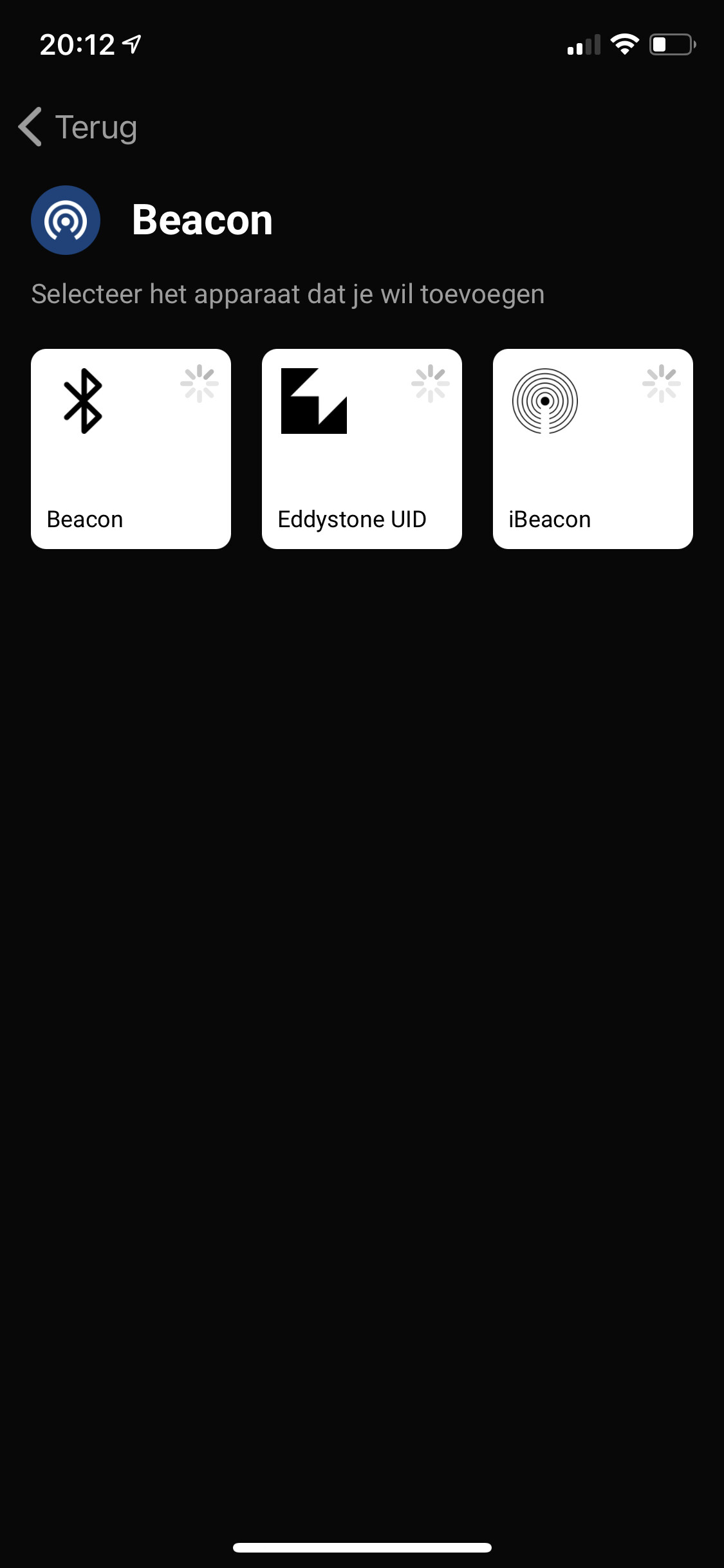

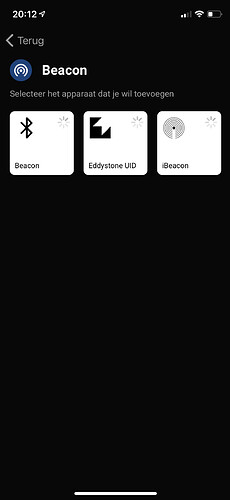

For a week now I’m trying to add a new beacon. The old one was worn-out. So when I press on the plus button and select the beacon app there are tiles with a loading motion. See screenshot
Can someone help me?
Fixed for me! but still false positives
