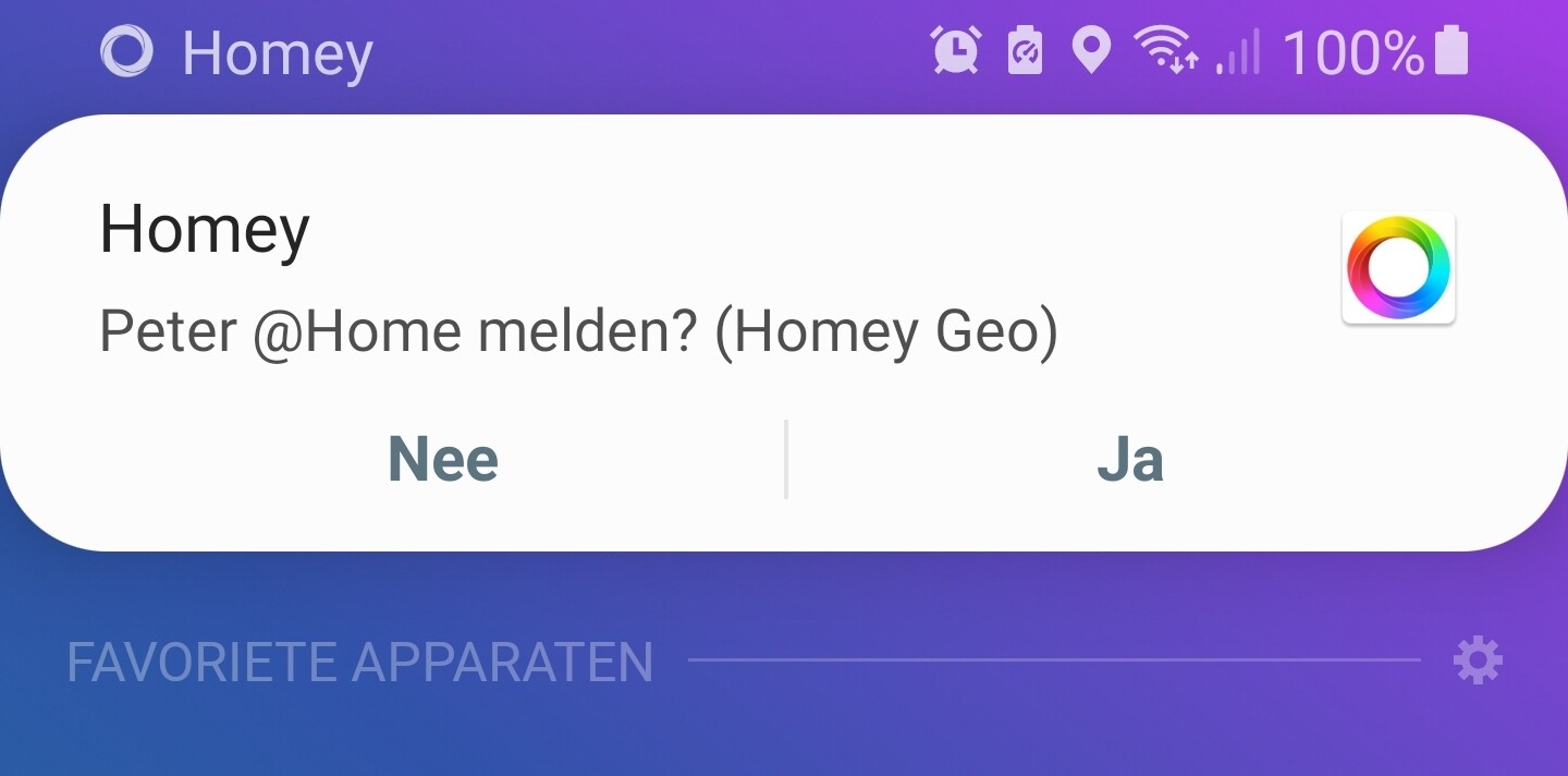

Btw. Are you asking your phone whether the system should set itself to away? What do you see on your phone? A yes/no. Or just the notification.
Yw.
A question with a yes or no option. Ignoring it is the same as answering “no”

I’ve done some testing, the ignore holds until the flow is triggered again. And then it just sends the same ack question again.
If yes turn light 2 on.
ELSE If no (is the same as ignored u say) turn light 3 on. Light 3 is never turned on, unless u click no urself.
