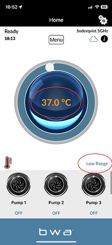

I have now tested the functions of the new version, the âthenâ card for the temp range now exists but it doesnât change the range on the spa. It changes from active to non active in the Homey app but not on the spa. It also doesnât change the temperature range that is possible to set. The temperature range that is possible to set is 26,5C to 40C, but when the spa is in low temperature mode the range should be all the way down to 10C.
Either the temperature range is variable to set depending on the temperature range (high/low) that is chosen or the temperature range is 10-40C always but that the temperature range mode must be switched between high and low for the temperature setting to take affect. Se pictures how the Homey now isnât syncing. If the spa is set on low mode and I adjust to 40C in the Homey app, the spa will go to 37 and just stop, also if the range is set to 16C in the BWA app, the Homey will still show 26,5C as set temperature.

I also checked that is happening when pushing the âtemperature rangeâ button in the Homey app, it changes the status for the temperature range but only in the Homey, it doesnât send/sync the info with the spa. (it doesnât affect the temperature dial, it is still 26,5-40C)

Just as information regarding the BWA module, as i have owned one. When you change the temperature range from Homey, try to give it some time and close (terminate) the BWA-app on your phone and re-open the BWA-app. You maybe have to try a couple of times, then suddenly the temperature scale is in âlow rangeâ mode. Be patient, the module can be really âbuggyâ.
