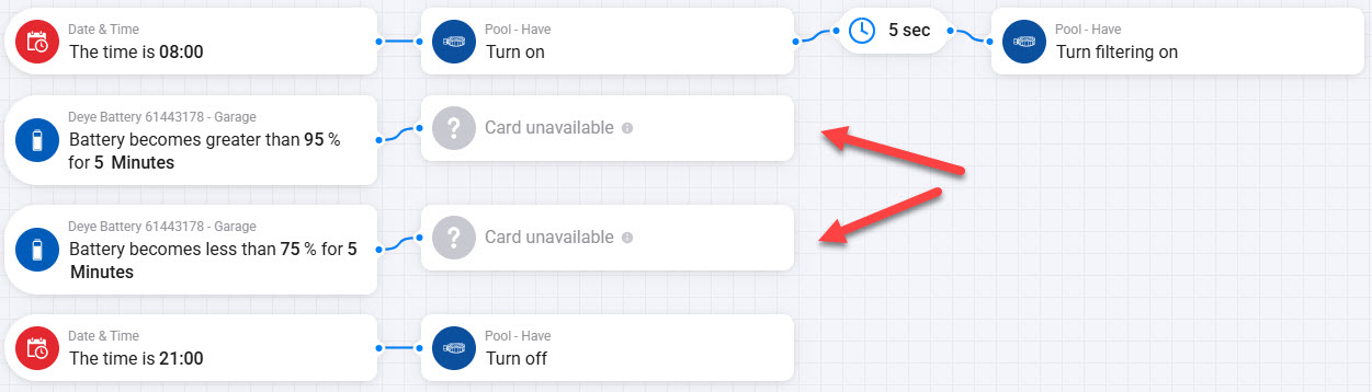

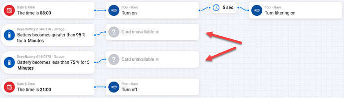

After the latest update, turn heater on/off is no longer available :-/
Hi Frank - Are you able to create new Cards?
Hi Andi
Yes, but heater on/off are no longer avalible
The App specifications also doesn’t mention any heater on/off - it matches what i experience - same cards:
For me it looks like this:
Strange…
