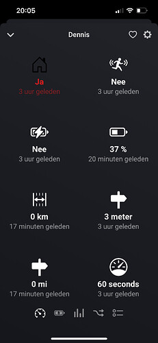

When i repaired my phone all kind of stuf stays at 3 hours. Not updating … my battery is 34% as we speak on my phone … but it is stuck at 37% in your app ( see screenshot )
Repaired my wifes phone and everything ( all values ) updated ( once )
Checked my wifes phone and wifi setting … exactly the same config
