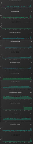

This is what my app memory looks like over the last 14 days:
It crashed / hung on the night of Apr 7th. It looks to me as though most of the apps are increasing in their use slightly but when the crash/hang happened all of them went up? Is that what you see too? I’m not sure why they would all request/require more memory all at once
Yes, that’s what I’m seeing too. It might be that each app is temporarily storing/queueing information because there’s something wrong with the Homey core process.
It might be worthwhile to send this data to Athom (support@athom.com) as well. Perhaps they can infer from these charts what might be happening.
If Homey was failing at the last peak, maybe all apps were failing due to memory issues and making it worse in the process, not cleaning up after an exception or something.
As far as I can tell Sensative and Hue show the most memory growth. Nest seems to have had a more memory hungry update but quite stable still.
Is it an idea to create flows reset those apps both every night to see if it will hold then?
This is what the Beacon app looked like for me. Way more pronounced than what you see, but you might witness the sawtooth on each time you reset an app too.
That’s a good idea - it seemed to me to be quite a significant thing if your OS/System clogs itself up to the extent that you can’t even generate a crash log / diagnostics report to work out why. But Having sent the charts and info, they didn’t offer any insight, just suggested to reboot once per month.
