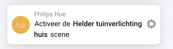

Is anyone else experiencing issues with the Homey Hue app since the last update of the app 2 days ago? Homey can’t control my light anymore. Testing a flow results in the below.
Already rebooted both Homey, the Hue App and the Hue bridge.
And
The [object Object] “error” is something that should be mentioned to Athom, it’s a bug in their app: support@athom.com
Yeah that’s what I already did. I find it a bit odd that online I don’t see anyone else with the same issue. :grinning:
