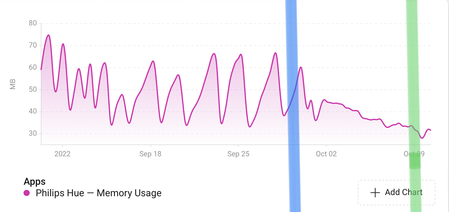

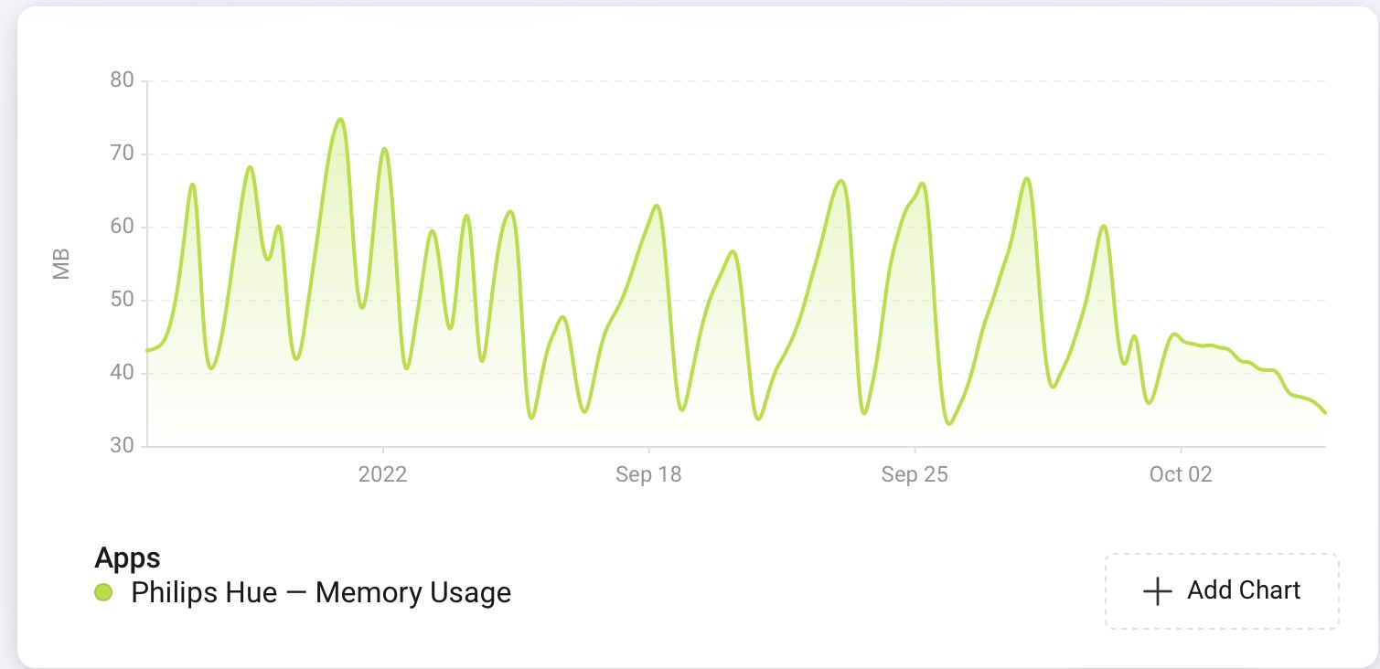

The Athom Philips Hue App has stabilised since, at Athom’s support recommendation I force a periodic restart of the App.
After trial and error found every six hours reduced memory usage down from 70mb to 40mb.
Now Homey is much more stable, not crashing 30 times a day.
So a win win, hopefully, eventually there is a replacement for this App that is more stable.
This is a graph I captured once I had started a 6 hour restart and had been trying daily then 12 hour restarts.

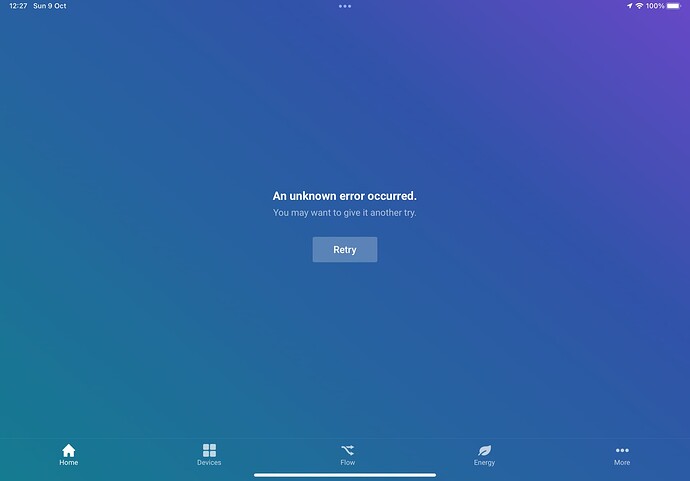

Well it finally killed my Homey :-j
I tried to add a new motion sensor I had added to Hue.
After selecting the Hue Hub it sat for 45 mins stuck trying to retrieve the Hue devices. I gave up.
Restarted the Philips Hue App.
Same issue.
Went to Homey settings and selected restart Homey, all I can get is
Hard rebooted Homey unplugged plugged back in and all get is the same.
Homey has lost its mind…. Homey is dead long live Homey :slight_smile: I guess time to dust off a Rasberry Pie and try HASS.

UPDATE 10 Oct 22
The Athom Philips Hue App memory usage appears to have improved radically since the Homey crash.
Before the Blue line is where the Hue app would crash, often taking Homey offline.
The Blue line is where I started automatically restarting the Hue App, on Athom support suggestion, first daily settling on every 6 hours.
The Green line was when Homey vomited, hard and took a very long time to reboot.
Since then the Athom Philips Hue app has been behaving.
Fingers crossed.
