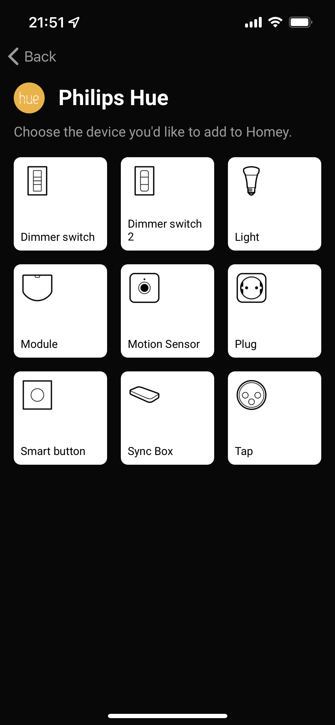

no have bridge in the app new version!
The app gets re-initialized, and probably tried to discover the Hue bridge, with no result.
Maybe if the app wasn’t updatet, a power outage / Homey restart would end with the same result: no hue bridge found
