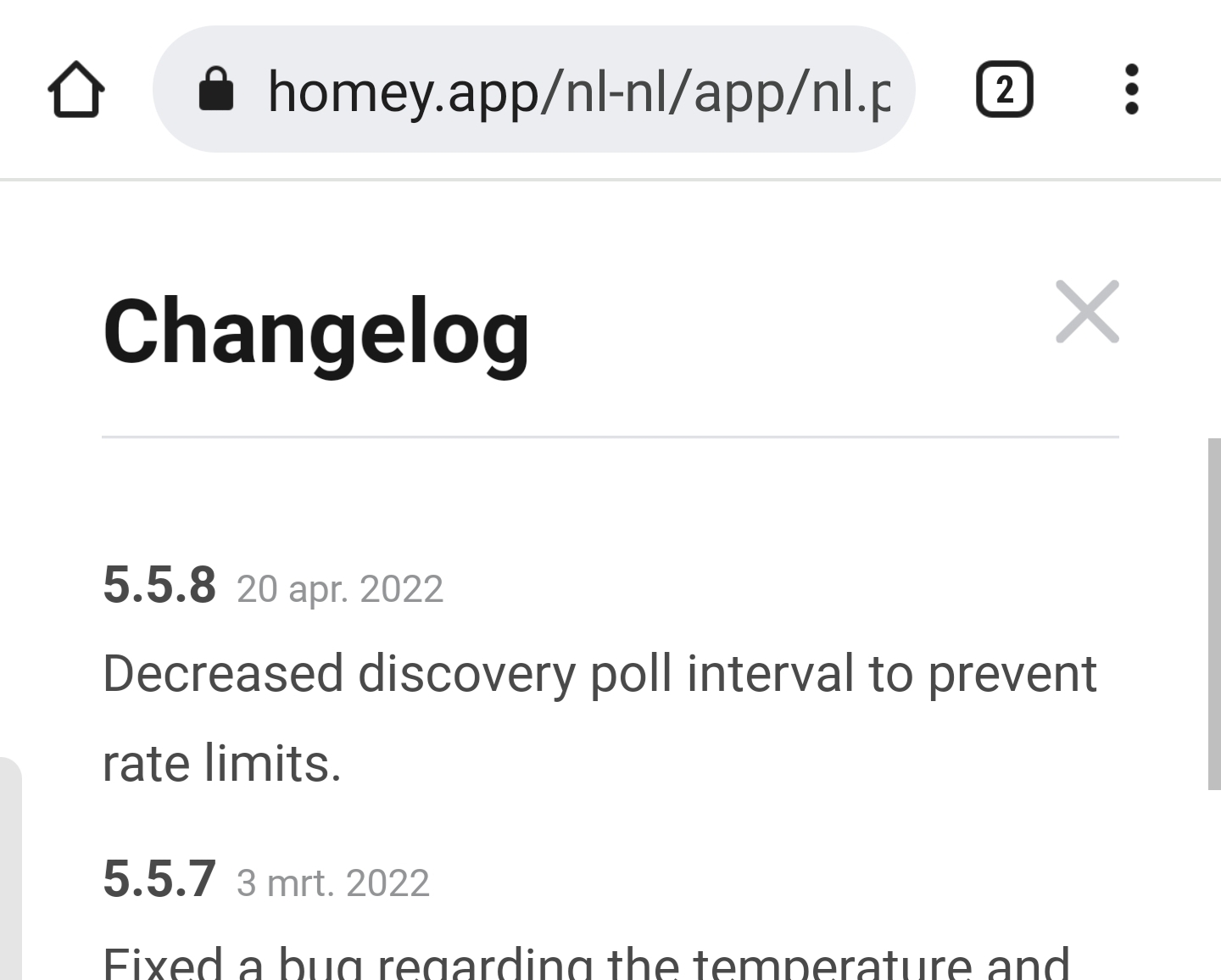

Because Hue has disabled a discvoerymethod for the Hue Bridge. They announced this back in 2021. Athom missed it.
" As per today, we deprecate UPnP as a local bridge discovery method, scheduled to be disabled in Q2 2022 ."
Therefore, reverting the Homey app will not change the outcome.
It would not have mattered in this case. The change was on the Hue side. Athom missed it.

This is to be found at the app page:

It is not related to the update. It is related to a change by Hue.
Restoring the app is useless therfore.
