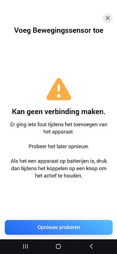

Hello i am new here sow hopefully this is the right way to ask for help.
Since the last ikea official app update the motion sensor what i have is very slow or does not work at all. The lamps just wont turn on according the flow. The flow is right but the sensor does not give a alarm at all.
What i did:
- reboot Homey pro 2023
- took the power of the Homey
- Restart ikea app
- Tried to repair the sensor over Homey
- Replaced batteries
- Removed device and add it again.
Adding the device cost me more then 25 attemps but still not works porbably. Detected one movement alarm and now nothing again.
Hopefully anyone can help. ![]()

Hi Robert, i just posted my problem here. Is there maybe a beta that i can install that might solve my problems. I have no lights now in my basment ![]()
There’s a test version available: IKEA Trådfri App for Homey | Homey
But your problem is most likely not related to the app but to Homey’s Zigbee itself.
Yes, just installed it. Not helpinf indeed. Any trick you know? Its frustrating ![]()
With Homey’s Zigbee, if it’s misbehaving, the “trick” is usually to reset the Zigbee network and start over ![]()
The compleet network?? And do i have to install all the devices again? Thats like 50 + ![]()
Yes. There might be other ways to (usually temporarily) fix your issue, but you’d have to search the forum for that because I’m not particularly up-to-speed with the latest “how to get my Homey working again” tricks.
Thank you very much. Another question. Is it useful to buy the ikea hub to update the devices?and is that possible without removing them from homey ![]()
If you want to update the devices, you will need an IKEA hub (or a better Zigbee controller, like zigbee2mqtt).
I can’t comment on whether it’s actually useful to update the devices.
No, Zigbee devices can only be paired with one controller.
