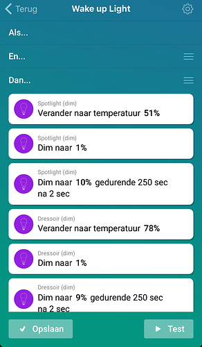

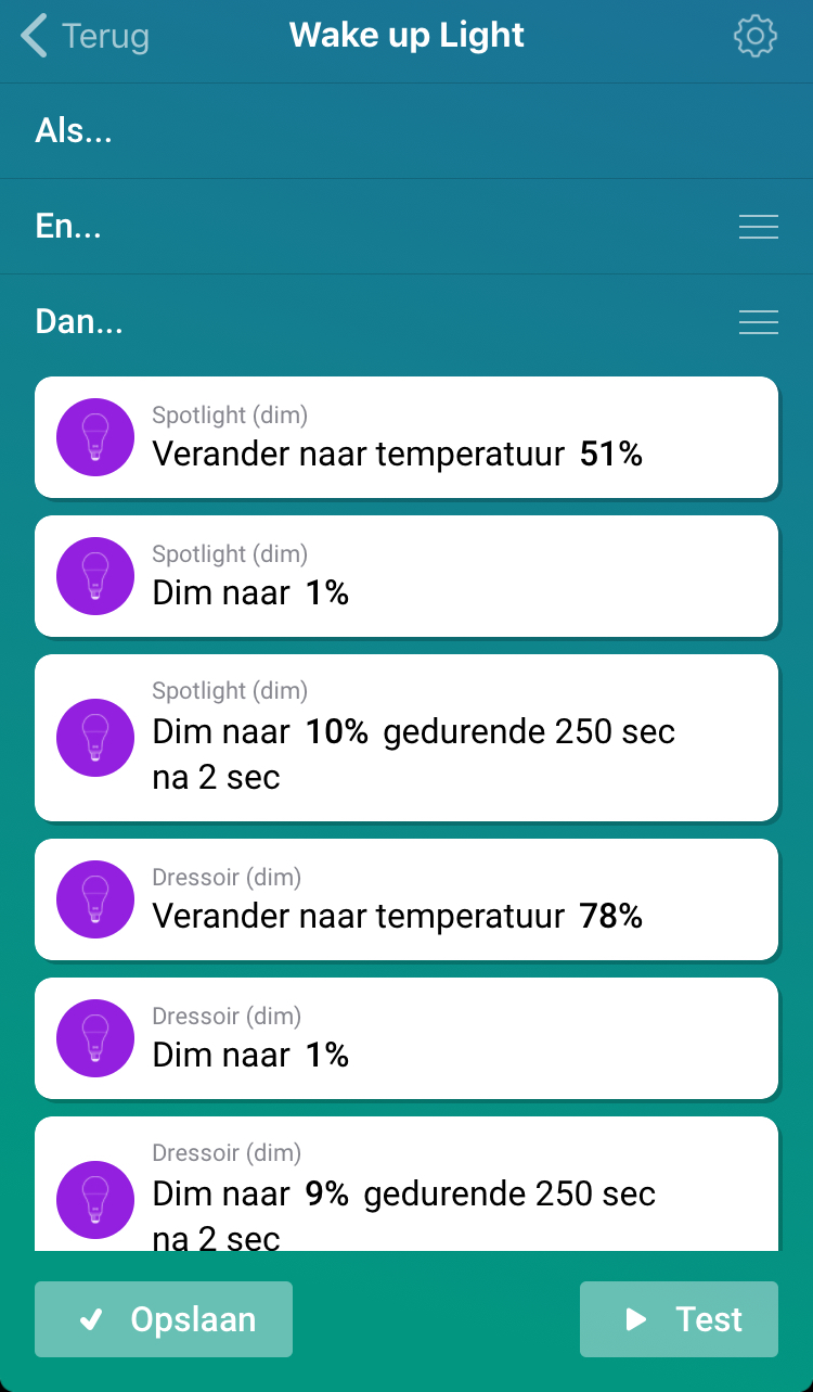

One of the first flows in the morning is this one. This morning, it didn’t work. Then I manually rebooted Homey from the app, retried the flow and it instantly worked again.
I’m now regretting the update even more…
Edit: the ‘if’ here is ‘When the time is 06:55’
