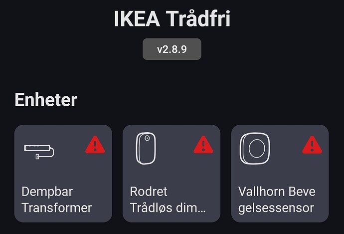

Hi! I see that Ikea Trådfri had an update 2 days ago and at the same time it stopped working for me. It says that the app is not available and when I try to restart it, I get that it is not installed… I have not yet tried uninstalling and reinstalling, but has anyone else experienced this? And what is the best thing to try? I have the devices connected directly to Homey Pro. No hub.
Will my Flows disappear if I uninstall and reinstall?
