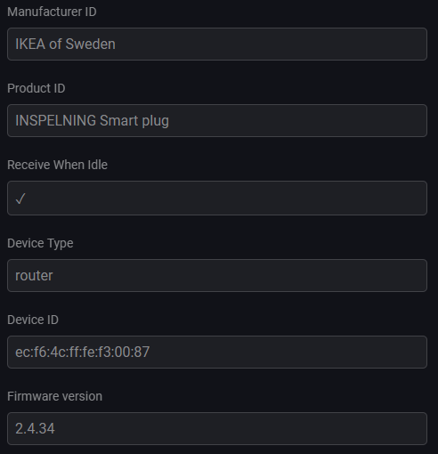

Just bought mine a few days ago.
and this is the version of firmware:

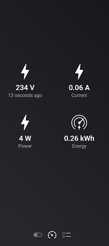

I have removed one working but not correct indicating Inspelning, now it seems to work proper and the strange slider is gone, because this is not a dimmer. So this is improved. Running update firmware 2.4.45 (updated with Dirigeria)
