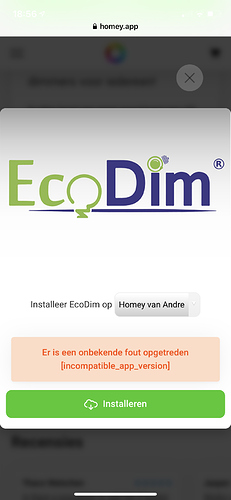

I couldn’t add the 2020. See a 1.1.1 version in AppStore. Could not update to it.
Removed the old one. Can’t install the new one
Perhaps it requires firmware 4.2.0? Assuming that you’re on 4.1.0, which is still the current stable version.
EcoDim app is compatible with the current stable release: “compatibility”: “>=4.0.0”,
@Andre_van_Dalen, you must be running a pre 4.x release; which version is that?

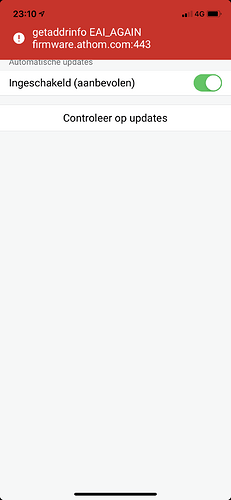

Homey versie 3.2.1
App versie 4.2.1.499
Ik heb update kunnen uitvoeren…
I was finally able to update !
Apparently homey and WiFi were arguing since a longer time.
I added homey to guest network and that worked as my regular network and phone hotspot didn’t work
