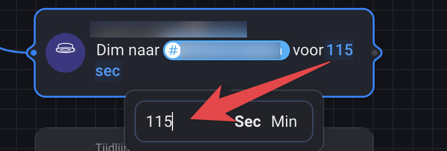

Imo The bulb does it self…
The card for the light is that it dims from A to B and it takes x seconds.

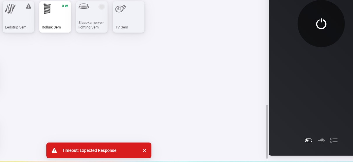

Hello Ted,
I receive an error on the EcoDim0.5 duo zigbee dimmer. The error message is: Timeout: Expected Response. The ligth will switch on but after a while I get the error. See attached image.
