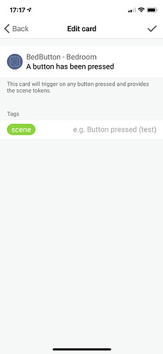

The Mini Switch is capable of Single Press, Double Press and Long Press function with its own HUB. How can I define it in the flow? Can someone show me an example flow that if the button is pressed twice X thing happens or when I long press the button Y thing happens etc…
Hi @Szergely.
You need to use the scene’s for that.
See some flows for example.
https://homey.app/nl-be/flow/0drQvx/
https://homey.app/nl-be/flow/LBuQvx/
https://homey.app/nl-be/flow/GjxQvx/
How change to Pressed 2x
A scène has been activated
Sorry, I don’t know where I can active this :weary: Can you tell / show me with screenshots :pray:
@Szergely you just posted the solution in previous response.
Omg :slight_smile: thx! :joy:
