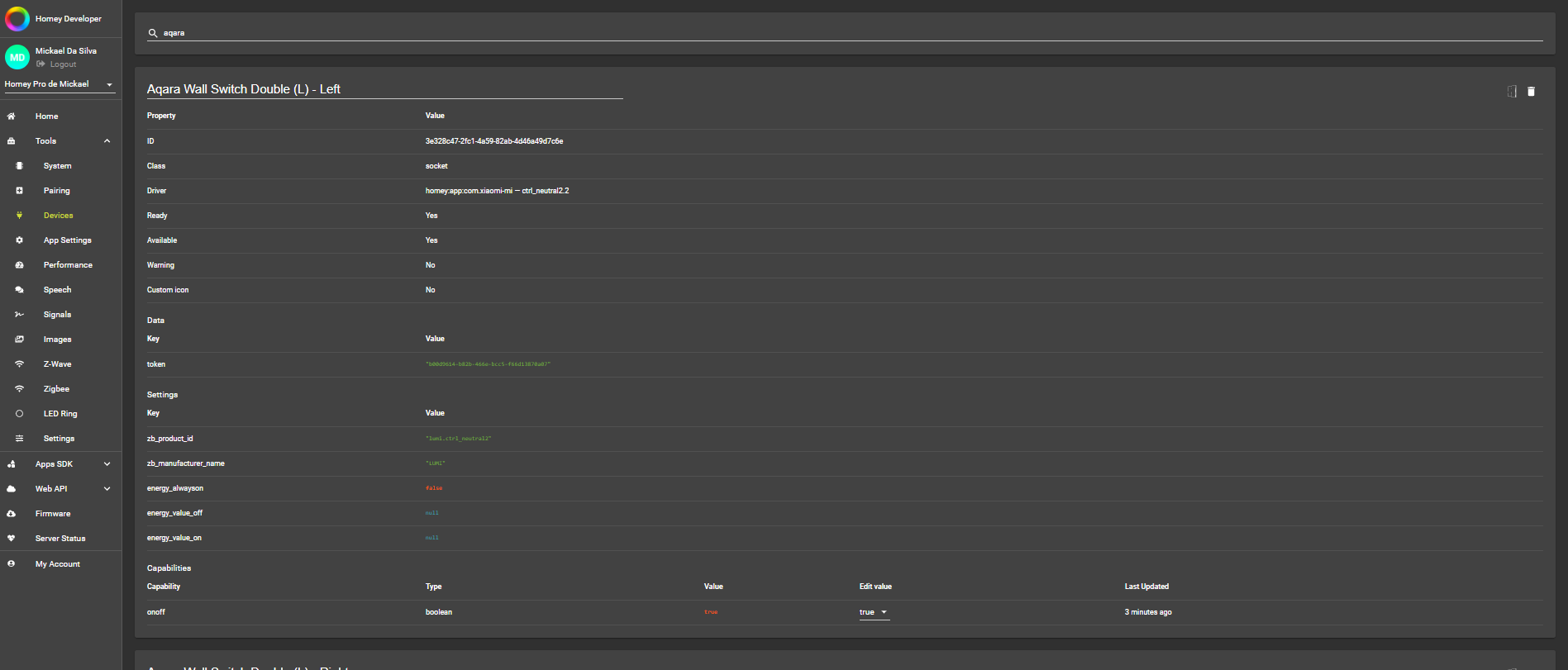

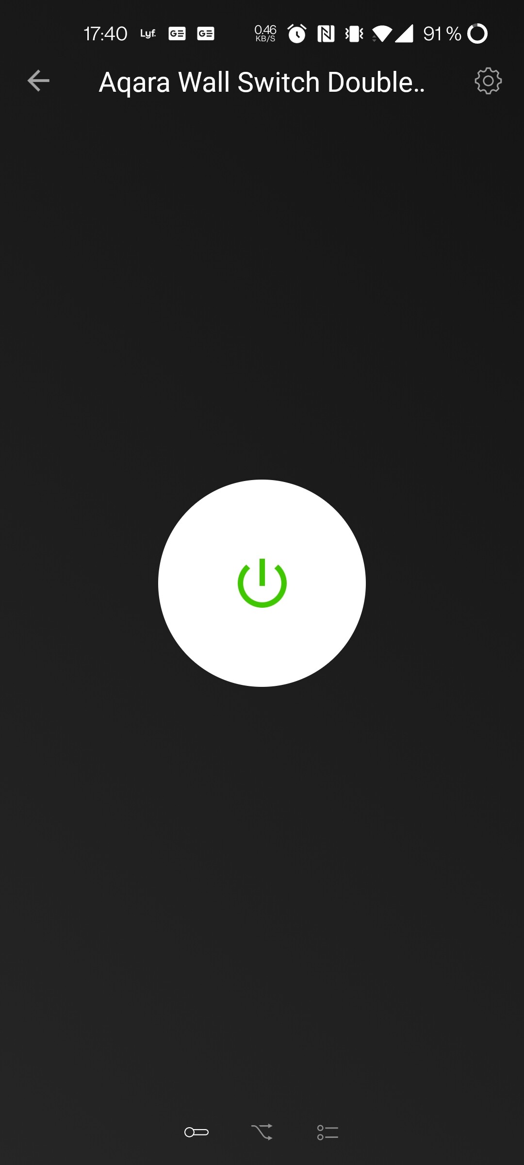

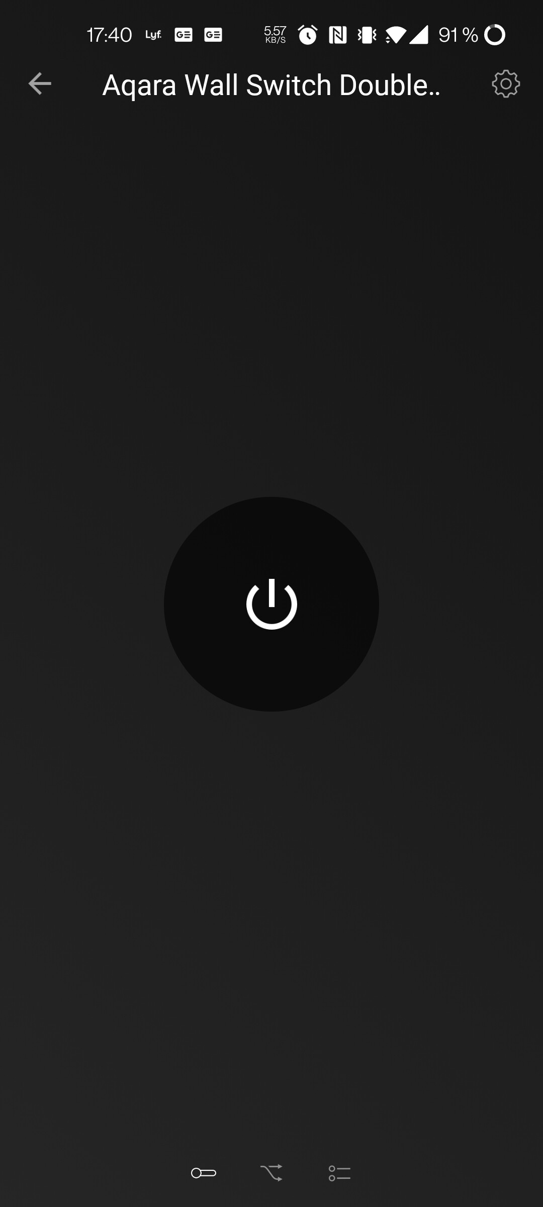

Hello, I update my homey but my aqara double rocker (L version, without neutral) doesn’t work anymore… It’s connected but no more action. I reset the zigbee network but unfortunately, it doesn’t work… The switch work with my aqara hub on Xiaomi home…
Have you the same issue with a double switch?

I use v5.0.2 of homey firmware, 1.2.6 of aqara app firmware.
The aqara double button is recognize by the homey, appears on my devices but no action. When I trigger the button, the aqara button doesn’t work.

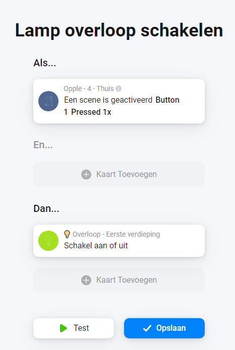

After that I created a flow to test it, like this
When I test the flow it works, but when I press a button on the Opple (tried all of them, tried double-clicking, tried holding) nothing gets triggered. I even added a card for sending me a push to test it, but that also does nothing. I tried other button numbers, I tried cards with double press etc.
