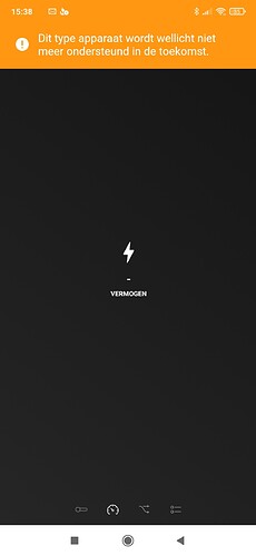

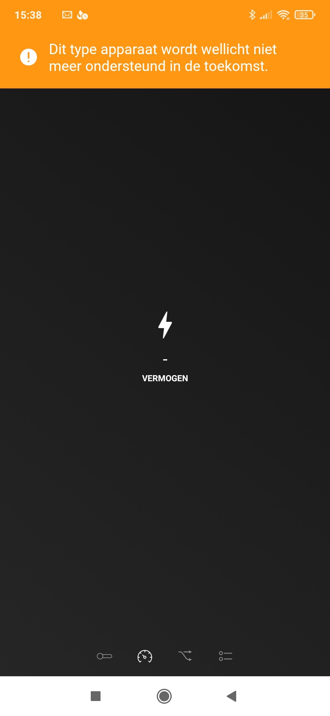

I saw this warning when selecting my Aqara Relay:
I searched the forum but could not find this before. Will support definitely be discontinued? For what reason?
Homey (Early 2016)
Firmware 5.0.1
App 1.2.5

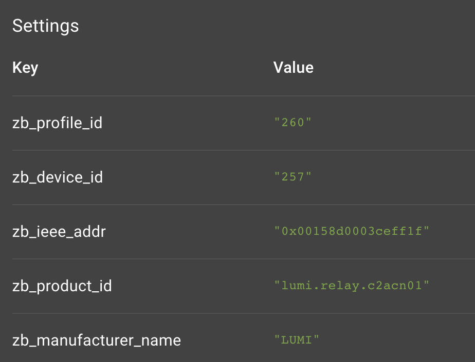

I have the same warning on my aqara double switches (with neutral)…
With the update to Homey v5, I have been able to fix one of the restrictions of the old Zigbee implementation; the lack of ability to create a subdevice for the second relay, which caused that the 2nd relay required a custom capability and flowcards that are not compatible with other apps (eg. Alexa / Google Home).
With Homey v5, I have fixed that by creating a new driver for these devices and marking the old drivers as deprecated; which is triggering the issue warning message shown.
No worries, the devices will keep working based on the deprecated drivers.
This is a generic message linked to the deprecated driver state I can’t change as developer.
Thanks Ted!
Does it also mean, when they decide to remove and re-add the device to Homey that the new driver will be used with the extra capabilities?
Yes.

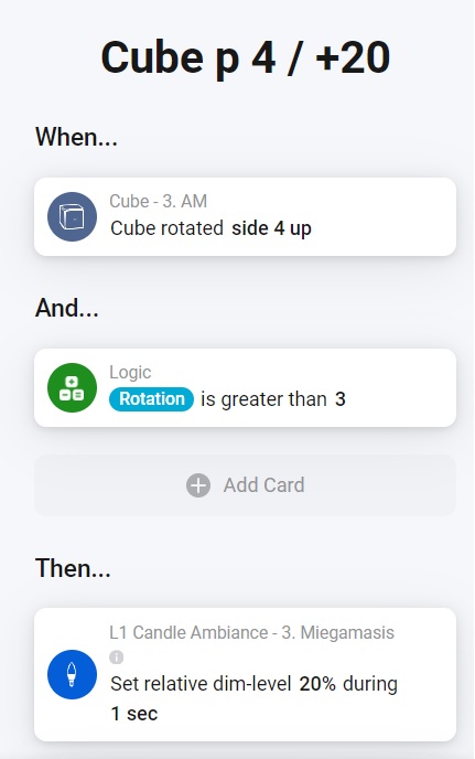

I’m still hoping to find a somewhat elegant solution for a fully wireless dimmer with a rotating button that can also be pressed to toggle the lights. Tyua has some nice ones, but they are all attached to wiring
Xiaomi cube?
