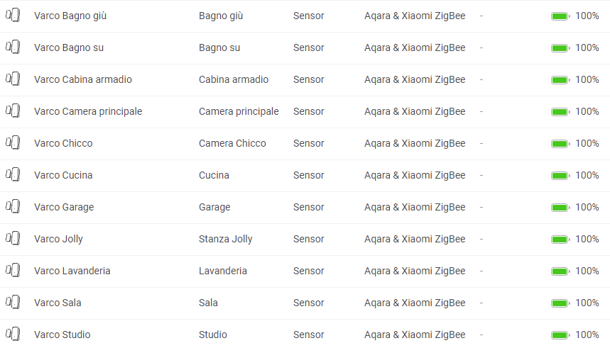

I can confirm that. All Aqaras that were taught in after the update to 5.0 no longer show any battery capacity. Everyone before the update doesn’t have this problem.
Not entirely true. I’ve been adding motion sensors and contact sensors and battery life is reflected, it just takes anywhere from an hour to a day before it shows up (probably has to wait for the first battery level push?)
For Aqara temperature devices they indeed have not pushed their battery life yet (been almost a week now)
I can confirm this, with me the contact sensors (window/door) do show battery percentage after an hour or so (as usual). Only the temperature sensors are not showing it in my case.
Do the devices start reporting the battery state when you press the button of the device / remove and re-insert the battery?
In my case no, they don’t. Pushing the button only reallign the link between device and Homey showing updated measurements, but the battery isn’t shown. Removing and re-inserting the battery lead to the same result.
