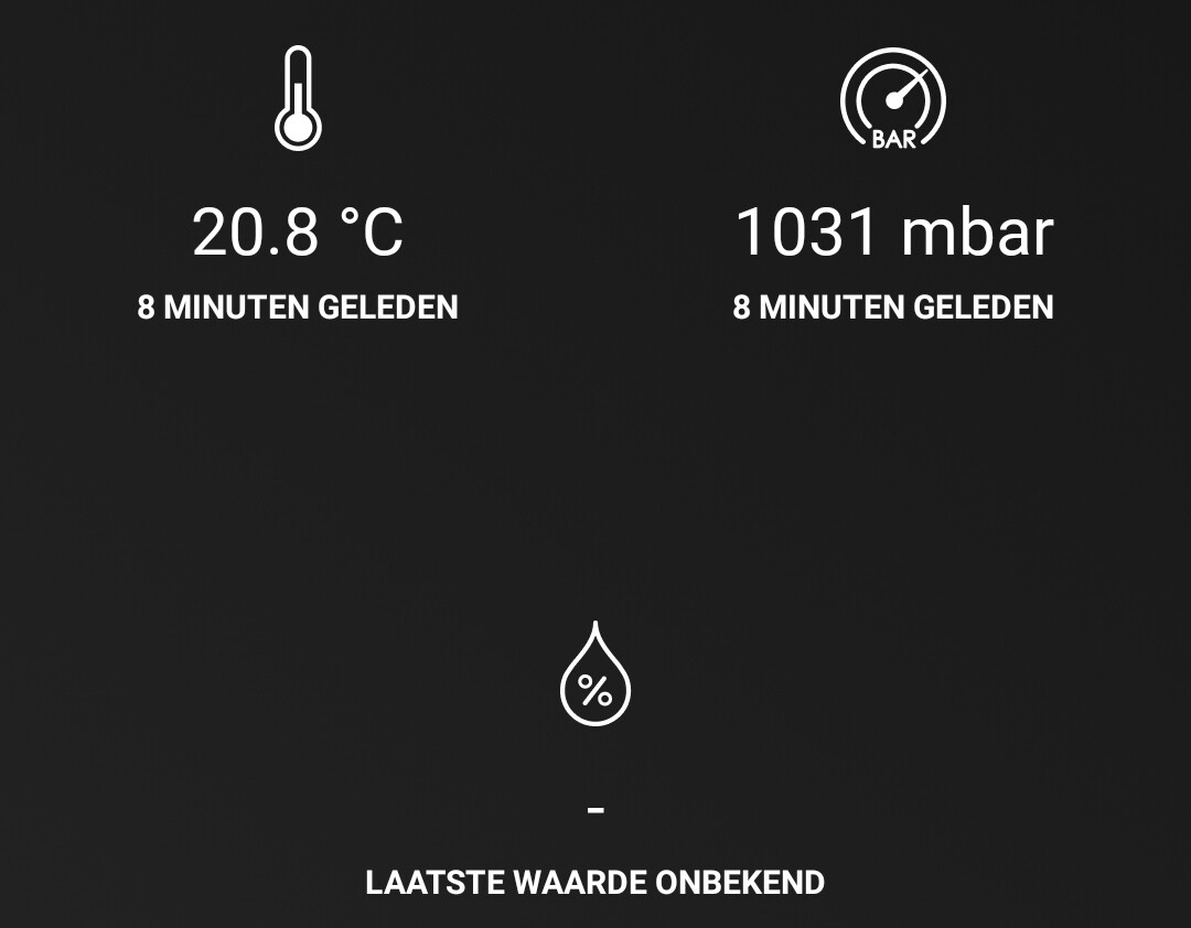

Battery percentage still unknown, and values are updated, except for the humidity:

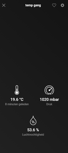

and the values are updating correct:

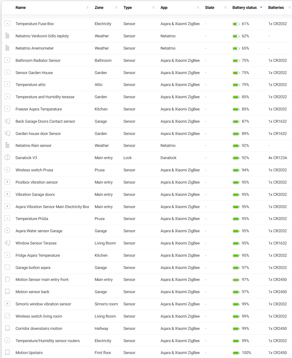

Btw, this is my status on v5 …and I haven"t performed ZigBee reset…

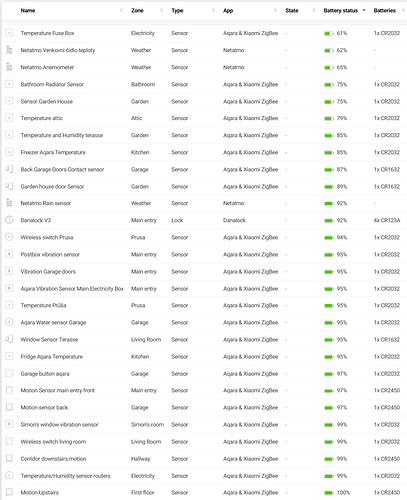

This is my list of the aqara only devices. Just 1 temp sensor that is misbehaving, concerning battery status.
