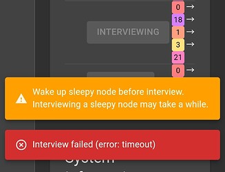

@TedTolboom I have exactly the same issue. Added an aqara temp sensor a week ago, but no battery percentage feedback yet. However status updates work fine.
  • Homey V5 (since official release)
  • Aqara 1.2.5
  • App 6.3.1
  • 9 routers / 13 end devices
  • No zigbee reset done
Edit: When I try to interview the temp sensor, it mentions a warning and a timeout error. The zigbee route is however visible. All info in one picture:
According to support, this is intended (interview error…don’t ask me why, I don’t consider that normal…). Is that sensor actually updating it’s values ?
It happened to me once … then I realized sensor do not update it’s values…I had to replace battery, even it was previously on 70% … since then it’s working again for me.

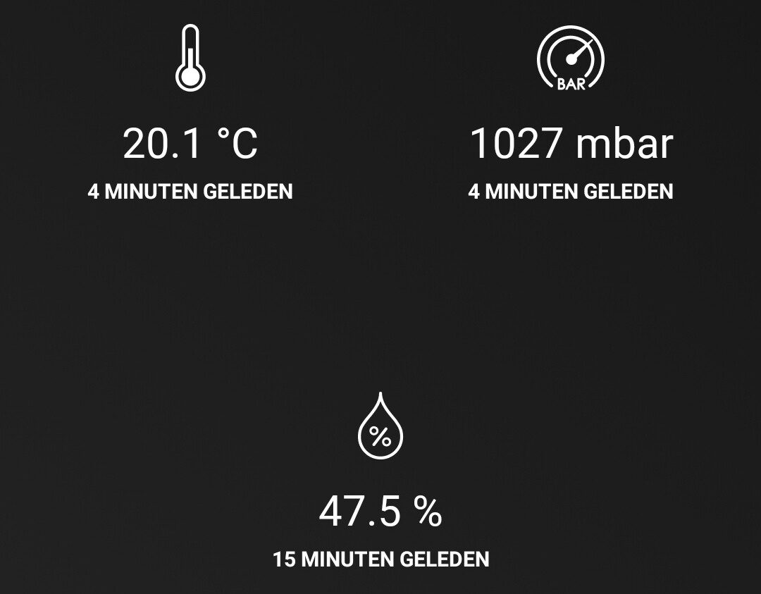

Yes it does update values:
So besides no battery indication, the device is working properly :thinking:
