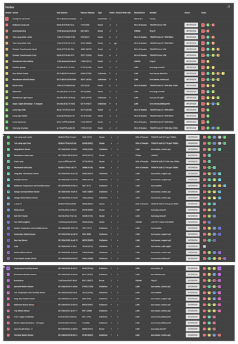

Looks like mine, buttons seem to work mostly 80% of the time, but temperature sensors range from 30 mins to several days between readings.
How is your Zigbee mesh?
Enough powered routers added?

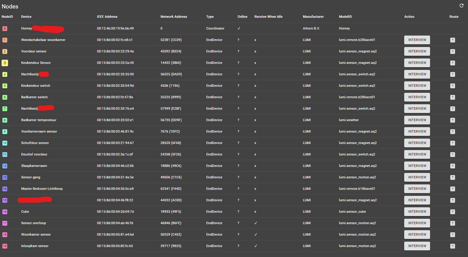

Which specific device are you trying to add?
Can you share a screenshot of the product ID’s when added as generic Zigbee device? App > generic Zigbee device > Settings > Advanced settings?
Is it possible to interview this device when added as generic device developer.Athom.com > tools > Zigbee > generic Zigbee device > interview > copy past the content shown
