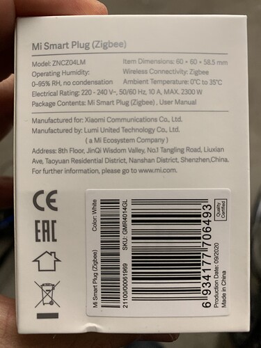

Is the smartplug (EU) ZNCZ04LM supported? @TedTolboom
edit : Sorry I see It’s supported. Can’t add it. Try first a PTP…
Edit2: After a check with a homey of a friend. I was sure it was a issue at my side. Did a zigbee Network reset and all works like a :rocket: (did a reset in the begining of v5.x experimental)
